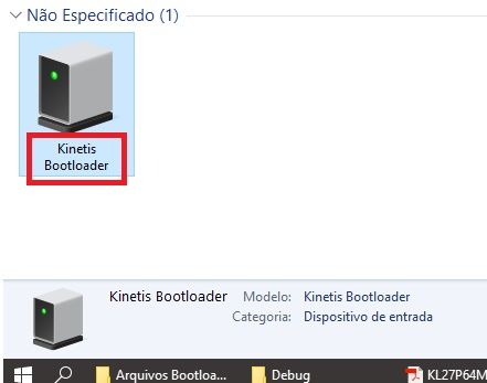

The “Manufacturer and Product Strings” are these strings that appear on the computer when it is connected or enumerated, like the image below:

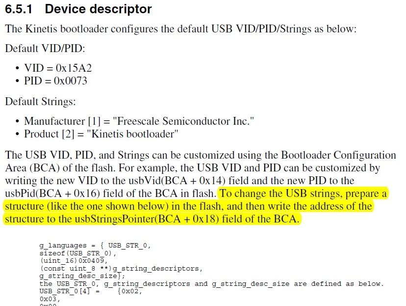

In the “KBTLDR120RM.pdf” document, (Kinetis Bootloader v1.2.0 Reference Manual), page 62, we have the idea of the offset address where the strings are situated, like the part of document shown below. In “FSL_Kinetis_Bootloader_1_2_0\apps\led_demo” we have just examples to IAR, and it configures the timeout of Kinetis Bootloader in the Startup configurations. There are available examples for KSDK 1.3 and KDS 3.1?
