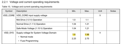

What I observed - When we provide supply from J8 and drop voltage, everything works fine but once we reach 2.1v the RF drops.
I also checked till 2.2V the SYS_LDO generate an output of 1.8V but as soon as we reach 2.1V the LDO generate 1.7V.
Additional Detail - I checked the HW recommendation guide and it shows that SYS_LDO supply power to System Domain. In both cases DCDC and Bypass.
The LDO_SYS output states it can output 1.71 to 1.98V at Normal Drive.
Additionally, it can Automatically passthrough once voltage reach to 1.98
System Domain Spec - The System Domain spec says in Normal mode it needs VDD_SYS of 1.8V to 1.98V.
Question - When I give input voltage of 2.1V, the SYS_LDO output is ~1.7V which is lower than requirement of System Domain, and as my passthrough will work only in case when voltage reach ~1.98V the System Domain will not get enough voltage to work? Is this the case?
I want to know why my RF Drops when you go from 2.2 ->2.1 V always.
Are we messing with some SW settings? Initially we thought must be custom board issue, but we faced same issue with EVK Board when supplied power through J8 and decreased voltage on step of 100mV/ 1V both.

I would like to add few more testing behavior, I am using BLE WUART Example Code. Bypass mode -
1. I provided SYSTEM Domain by my own other power supply, but the results are same. The RF Disconnect (I cannot see anything on BLE) once my supply from J8 pin drop below 2.1 (Exact 2V).
2. I provided my VDD_RF with external supply 1.8V . Same behavior, the RF cannot be seen once my supply from J8 pin drop below 2.1 (Exact 2V).
3. I provided my LDO_CORE with external supply of 1.1V, The RF once my supply from J8 pin drop below 2.1 (Exact 2V) disconnect.
