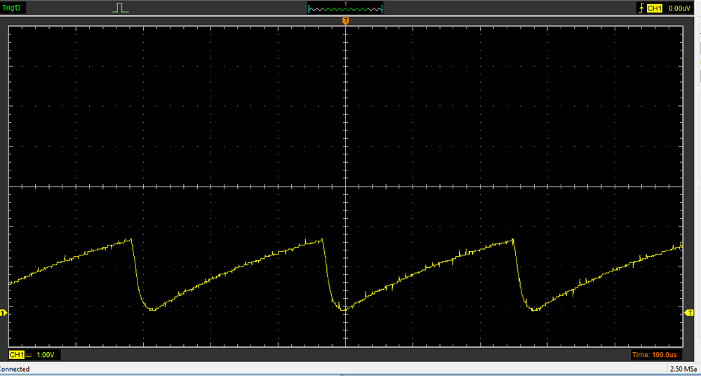

I have a design of customized board for control board based on KV10Z32VL7 .the signal on the reset pin is shown at the graph below.
the watchdog timer is disabled.

amerzater
I realized that the problem was in NMI_b , in my design I am using it as an output connected to an optocoupler . it seems that the opto was pulling down the NMI_b during the startup. when I removed the connection between that Pin and the opto , it simply worked.
now, any idea how to use NMI_b as an output without affecting the startup procedure?

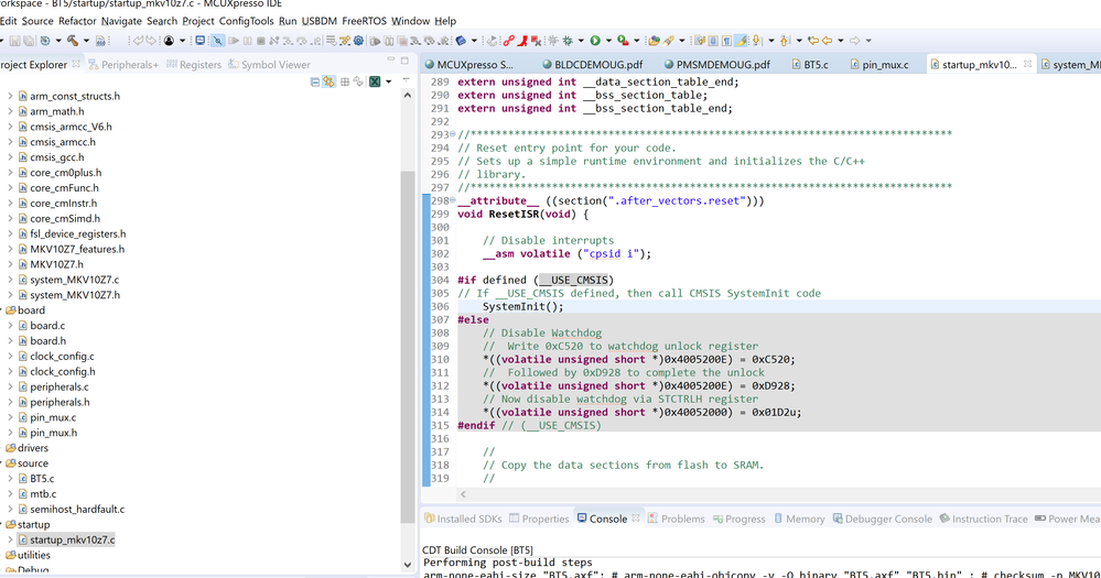

amerzater
resetISR routine is showen at the image below.which clears that WDG is disabled right after the reset.ISR.png

Hui_Ma
The code below SystemInit() is gray, which doesn't included during compile.

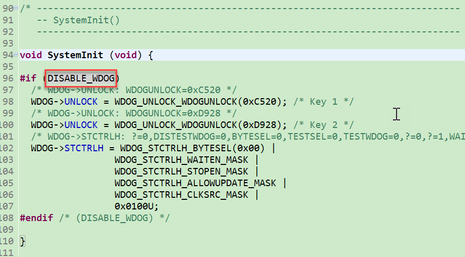

The SystemInit() function provided disable Watchdog function with default DISABLE_WDOG definition.
From you description,  could you check if you can debug into main() function?
If not, which code will cause the chip reset?

amerzater
Many Thanks, Mr. Mark
actually, I have DISABLE_WDOG defined as 1 already..
but running any example code is causing the chip to reset it self..
