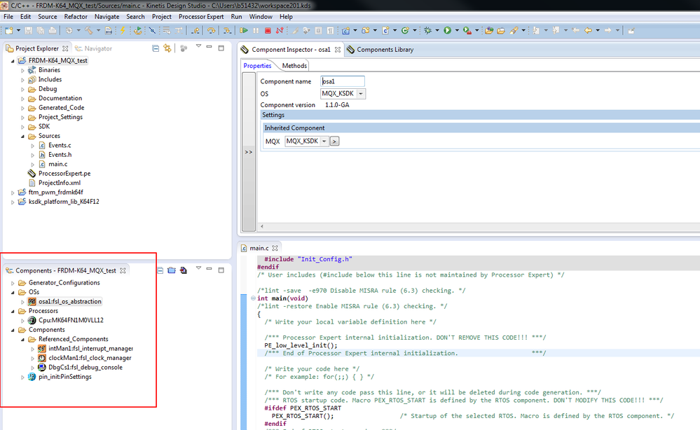

Hi Christie,
We only need select the MQX_KSDK under the "fsl_os_abstraction" component. Needn't add the mqx_ksdk component.
About the detail I have show on there :
KSDK 1.1.0 and KDS 2.0
Hope it helps
Alice

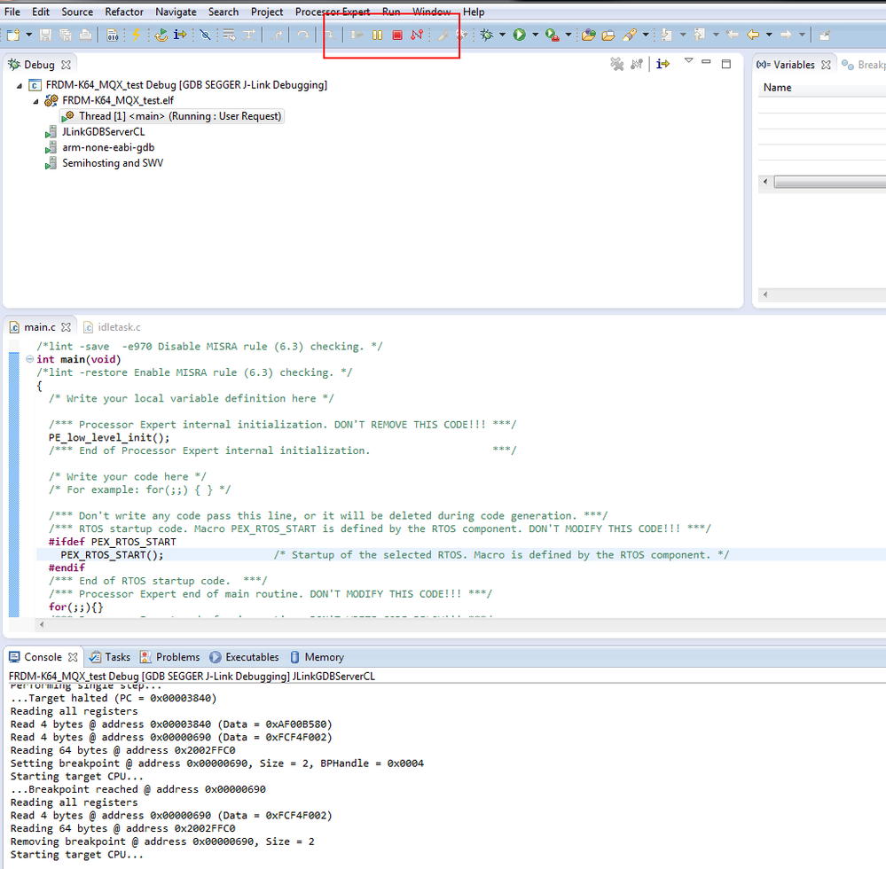

5,955 Views
a8Chcx
Contributor V
Hi Alice,
I created the exact same project as that you propose to JunFeng. When I debug the code, I got the above error message. See attached file.
Christie

Hi Christie,
On my side, refer to you said , I create a simple demo , it can work well , and below is the view screenshot , please see the different between us .
I can't repetition your problem  , and  I am puzzled , in the SDK_PE, where is the "MQX_Lite"  ?  please attache yours like me .
Alice
