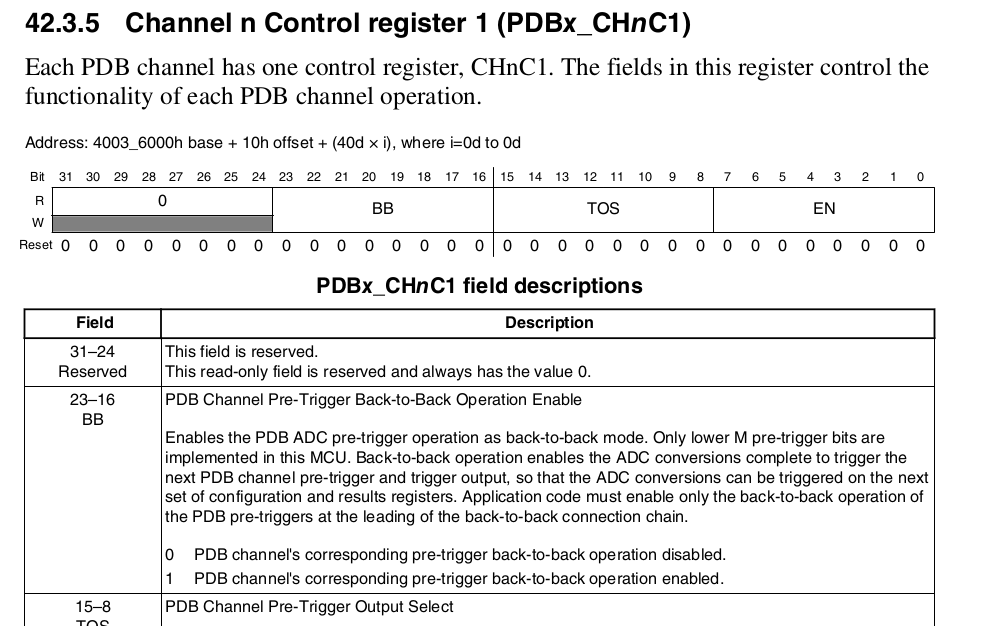

I have tried to go through all the possible related reference manuals and example code project about the usage of triggering the ADC0 [ch 0 ~2]conversion sequentially by PDB and use DMA P2M to copy the conversion result to buffer over back to back mode .
So that the PDB0.ch0pretrig0 pretriggered the ADC0.ch0 to do the ADC conversion and then emit a ADC.COCO complete flag to the DMA0 , DMA0 starts to copy the result from ADC0.R[0].
PDB0.ch0pretrig1 is then automatically pretriggered the ADC0.ch1 conversion and the result goes to ADC0.R[1] -> DMA0 copy it as well..
PDB0.ch0pretrig0 ->  ADC0.ch0 ->ADC0.R[0] -> DMA0->P2M->
PDB0.ch0pretrig1 ->  ADC0.ch1 ->ADC0.R[1] -> DMA0->P2M->
PDB0.ch0pretrig2 ->  ADC0.ch2 ->ADC0.R[2] -> DMA0->P2M-> PDB0.ch0 ->  ...
  But I am  still not really sure the correct  way to configure the PDB in such scene ...
Here is my config :
1. please help to correct.....
2. if I set in this way, is that possible kick it to start?
The manual (KM34P144M75SF0RM.pdf ) says I can control the pretrigger   channel by assigning the CHnC1.BB register.
So I guessI need to configure the enableBackToBackOperationMask w.r.t PDB0 pretrigger channel with certain delay
i.e.:
  PDB0.ch0 : pdbAdcPreTriggerConfigStruct.enableBackToBackOperationMask = 0U;
  PDB0.ch1 : pdbAdcPreTriggerConfigStruct.enableBackToBackOperationMask = 1U;
  PDB0.ch2 : pdbAdcPreTriggerConfigStruct.enableBackToBackOperationMask = 2U;
and XBAR setting:
    XBAR_Init(XBAR);
    /* Configure the XBAR signal connections. */
    /* Configure the XBAR interrupt. */
    xbarConfig.activeEdge = kXBAR_EdgeRising;
    xbarConfig.requestType = kXBAR_RequestDisable;
    XBAR_SetSignalsConnection(XBAR, kXBAR_InputPdb0Ch0Pretrigger0, kXBAR_OutputPdb0PreTrigger2Ack );
    XBAR_SetOutputSignalConfig(XBAR, kXBAR_OutputAdcTrgA, &xbarConfig);
    XBAR_SetSignalsConnection(XBAR, kXBAR_InputPdb0Ch0Pretrigger1, kXBAR_OutputPdb0PreTrigger0Ack );
    XBAR_SetOutputSignalConfig(XBAR, kXBAR_OutputAdcTrgB, &xbarConfig);
    XBAR_SetSignalsConnection(XBAR, kXBAR_InputPdb0Ch0Pretrigger2, kXBAR_OutputPdb0PreTrigger1Ack );
    XBAR_SetOutputSignalConfig(XBAR, kXBAR_OutputAdcTrgC, &xbarConfig);

I could make it work without using PDB back to back mode.
Thanks to the result register is at successive memory ( ADC0.R[4] ),   I can use DMA with the M2M and cycle steal mode such that it can change the source and destination of each ADCC.OCO request per DMA read/write cycle.  Therefore, no  ADC coco conflict during DMA transfer. I just got it done yesterday.
By the way, I am trying to make it work with the back to back mode but I did not  succeed. Could you please provide me a complete code example base on the above case?
I have tried to set SIM mode into PDB ADC trigger and
SIM->MISC_CTL = ((SIM->MISC_CTL &    (~(SIM_MISC_CTL_UART2IRSEL_MASK)))                       /* Mask bits to zero which are setting */      | SIM_MISC_CTL_UART2IRSEL(MISC_CTL_UART2IRSEL_NONE)    /* UART2 IrDA Select: Pad RX input PTI[6] or PTE[6] selected for RX input of UART2 and UART2 TX signal is not used for modulation */    );  SIM->MISC_CTL |= SIM_MISC_CTL_PDBADCTRG(1) ;/*pick PDB as the ADC HW trigger source instead of Xbar*/
adc16ChannelConfigStruct.channelNumber = 0;      adc16ChannelConfigStruct.enableInterruptOnConversionCompleted = false; /* Enable the interrupt. */
ADC16_SetChannelConfig(ADC0, adc16ChannelConfigStruct.channelNumber, &adc16ChannelConfigStruct);
  adc16ChannelConfigStruct.channelNumber = 1;
  ADC16_EnableHardwareTrigger(ADC0, true);      DMA_Configuration();      /* Enable DMA */
ADC16_EnableDMA(ADC0, true);
PDB_GetDefaultConfig(&pdbConfigStruct);
pdbConfigStruct.prescalerDivider = kPDB_PrescalerDivider4;
PDB_Init(PDB0, &pdbConfigStruct);    /* Configure the delay interrupt. */
PDB_SetModulusValue(PDB0, 3900U);//3900 = 166us / 24MHz    /* The available delay value is less than or equal to the modulus value. */
PDB_SetCounterDelayValue(PDB0, 3000U);
PDB_DisableInterrupts(PDB0, kPDB_DelayInterruptEnable);
pdbAdcPreTriggerConfigStruct.enableBackToBackOperationMask = (1U << 0 ) | (1U << 1) ;
pdbAdcPreTriggerConfigStruct.enablePreTriggerMask = (1U << 0 )| (1U << 1) ;
pdbAdcPreTriggerConfigStruct.enableOutputMask = 0 | (1U << 1) ;‍‍‍‍‍‍‍‍‍‍
PDB_SetADCPreTriggerConfig(PDB0, 0, &pdbAdcPreTriggerConfigStruct);
PDB_SetADCPreTriggerDelayValue(PDB0, 0, 0, 0);
PDB_SetADCPreTriggerDelayValue(PDB0, 0, 1, 1200);
PDB_DoSoftwareTrigger(PDB0);‍‍‍‍‍‍‍‍‍‍‍‍‍‍‍‍‍‍‍‍‍‍‍‍‍‍‍‍‍‍‍‍‍‍‍‍‍‍‍‍‍‍‍‍‍‍‍‍‍‍‍‍‍‍‍‍‍‍‍‍‍‍‍‍‍‍‍‍‍‍‍‍‍‍‍‍‍‍‍
but it seems not working.

     * adc16ConfigStruct.longSampleMode = kADC16_LongSampleDisabled;
     * adc16ConfigStruct.enableHighSpeed = false;
     * adc16ConfigStruct.enableLowPower = false;
     * adc16ConfigStruct.enableContinuousConversion = false;
    ADC16_GetDefaultConfig(&adc16ConfigStruct);
    adc16ConfigStruct.enableHighSpeed = true;
    adc16ConfigStruct.longSampleMode = kADC16_LongSampleCycle10;//kADC16_LongSampleDisabled;
    adc16ConfigStruct.resolution = kADC16_ResolutionSE16Bit ;
    ADC16_Init(ADC0, &adc16ConfigStruct);
    ADC16_SetHardwareAverage(ADC0, kADC16_HardwareAverageDisabled);//kADC16_HardwareAverageCount4);//
  #if defined(FSL_FEATURE_ADC16_HAS_CALIBRATION) && FSL_FEATURE_ADC16_HAS_CALIBRATION
      ADC16_EnableHardwareTrigger(ADC0, false);
      if (kStatus_Success == ADC16_DoAutoCalibration(ADC0))
  //        PRINTF("ADC16_DoAutoCalibration() Done.\r\n");
  #endif /* FSL_FEATURE_ADC16_HAS_CALIBRATION */
      /* Enable DMA */
int main(void)
    /* Init board hardware. */
    BOARD_InitPins();
    BOARD_BootClockRUN();
    BOARD_InitDebugConsole();
    APP_VREF_Config();
    ADC_Init();
    pdb_config_t pdbConfigStruct;
    pdb_adc_pretrigger_config_t pdbAdcPreTriggerConfigStruct;
    /* Configure the PDB counter. */
     * pdbConfigStruct.loadValueMode = kPDB_LoadValueImmediately;
     * pdbConfigStruct.prescalerDivider = kPDB_PrescalerDivider1;
     * pdbConfigStruct.dividerMultiplicationFactor = kPDB_DividerMultiplicationFactor1;
     * pdbConfigStruct.triggerInputSource = kPDB_TriggerSoftware;
     * pdbConfigStruct.enableContinuousMode = false;
//    pdbConfigStruct.enableContinuousMode = true;
    /* Configure the ADC Pre-Trigger. */
    pdbAdcPreTriggerConfigStruct.enableBackToBackOperationMask = 0 | (1U << 1) ;
    pdbAdcPreTriggerConfigStruct.enablePreTriggerMask = (1U << 0 )| (1U << 1);
    /* The available Pre-Trigger delay value is less than or equal to the modulus value. */
    PDB_DoLoadValues(PDB0);
    while (1)
        /* Wait next triger from user */
        PRINTF("Press any key to trigger ADC conversion\r\n");
        GETCHAR();
        g_bAdcConvDone = false;
        while (!g_bAdcConvDone)
        /* Print result */
          PRINTF("ADC 16 value  = %05d   %05d    \r\n",  i32a_adc16result[0], i32a_adc16result[1]);
        /* Software trigger conversion */
2,489件の閲覧回数
xiangjun_rong
Hi, Nick,
Sorry for the delay.
Based on your solution, the PDB module triggers ADC_SC1A and ADC_SC1B in one PDB cycle, you use DMA to transfer ADC_RA and ADC_RB to memory. As I said the solution is not feasible, because both the COCO event of ADC_SC1A and ADC_SC1B can trigger DMA, but you do not know which sample should be transferred ADC_RA or ADC_RB once DMA is triggered.
In your code:
DMA_PrepareTransfer(&g_transferConfig, (void *)(&ADC0->R[0]), sizeof(uint32_t),
                        (void *)&i32a_adc16result, sizeof(uint32_t), sizeof(i32a_adc16result),
                              kDMA_MemoryToMemory);/*move both SRC and DES => ADC0->R and result buff*
You transfer ADC0->R[0], where is ADC0->R[1]?
I suggest you use interrupt mode to transfer data to memory.
Xiangjun rong
2,489件の閲覧回数
nickng
Hi Xiangjun,
It is running at memory to memory mode and in cycle steal , therefore it will increase both addresses (source and destination ) per adc coco. And they are triggered by PDB sequentially. Every adc triggering cycle has only  on adc in active.
you may try to test  the code but
pdbAdcPreTriggerConfigStruct.enableBackToBackOperationMask = 0;
It should work.
Nick
