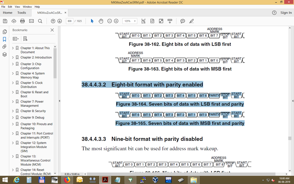

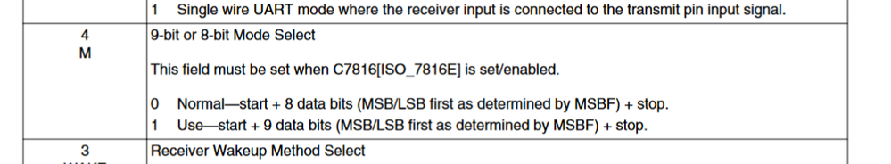

Please check snippet below. 7 bit data is not supported, you can only set 8 or 9 bit data by setting M bit in the UART_C1 register.
Felipe

 May it will support (7E1)7 bit data,1parity and 1stop bit
UART_C1 register -  if  i enable SET(UART_C1_PE_MASK) ,7E1 should work but for me not working why? any other configuration need?

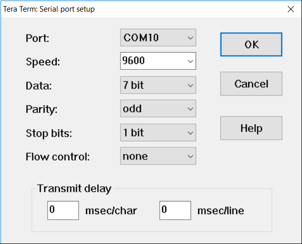

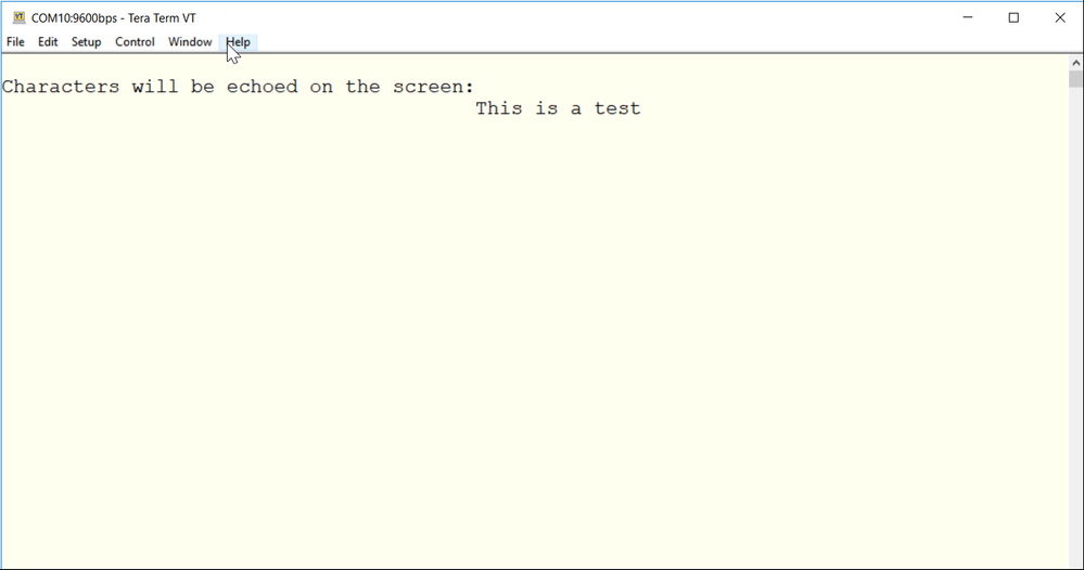

Please accept my apologies for the late reply. I did the following testing to work with 7 bits data and odd parity and it worked well.
I am using TWR-KM34Z50MMV3 board (KM34Z128 MCU same as yours) and I used the uartisr_test example you can download from https://www.nxp.com/downloads/en/lab-test-software/TWR-KM34_DEMO_SW.zip
I modified this example by configuring UART_C1[PE] | UART_C1[PT]. This were the only changes I made, please see attached the modified header file.
I configured the serial term as follows:
Using this I got the following behavior:
As you can see TX and RX worked correctly with 7 bits data and odd parity.
I hope this helps you.
Felipe
