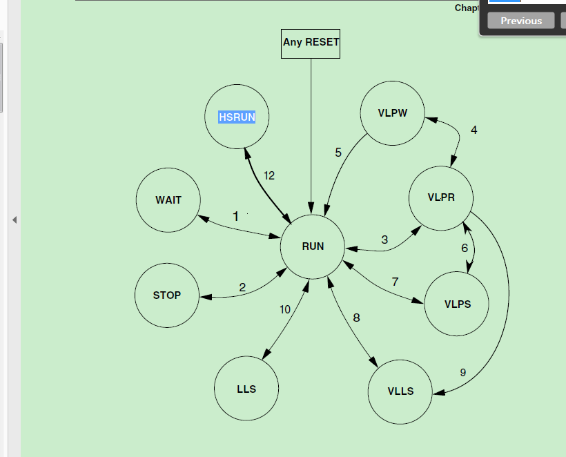

I do have an issue switching from HSRUN mode to RUN mode.
After the configuration of the clocks, CLOCK_GetFllFreq() return 0 and my program is not working.
Although if I start in RUN mode, CLOCK_GetFllFreq() returns the correct value.
Can you please help me figure out, what I am missing when switching from HSRUN to RUN?

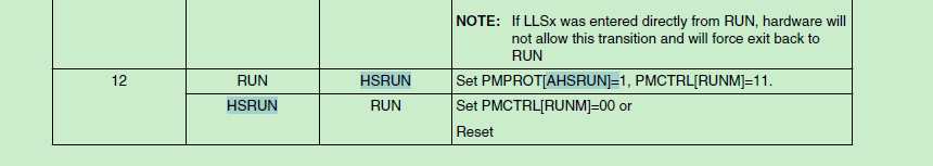

kerryzhou
Hi marcwillem ,
  Do you check the run mode clock, whether you meet the following requirements:
The HSRUN can change to the RUN mode:
Please double-check the above points.
Make sure the core, bus clock meet the requirement, then set PMCTRL[RUNM]=00.
   Wish it helps you!
   If you still have questions about it, please kindly let me know.
Kerry
