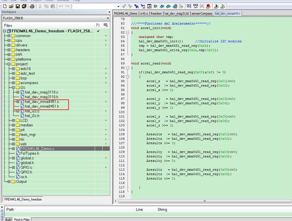

bertan7
Hey Thank you for your answer,
but I can't find the code in the link for reading the accelerometer.
There is just a main.c file with: int main() and return(). in it
But I already have a demo called Bubble where I can send out the acc data
Now I need the code for reading the gyro on the 9-axis, to add it to the accelerometer data
Do I just have to change the PINs and addresses?
2,942 Views
kerryzhou
Hi Bertan,
    Please see this picture:
    That's the accelerator code.
    About whether you need to change the PINS and address, it determined by your hardware, you should choose the according pin which your sensor are using, the address you should read your sensor's datasheet.
  I don't have the 9-axis code directly, you need to write the code by yourself and refer to the accelerator code.
