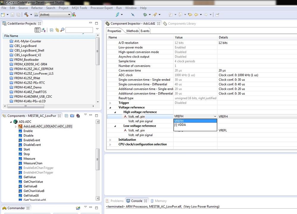

I am using PE to setup the ADC and other peripherals
and even with PE set to Expert, I don't see an option to use the bandgap as the ADC reference.
I am using the ADC_LDD component and for ADC Reference all I get is
High Voltage Reference
                  1) VREFH
                  2) VDDA
Low Voltage Reference
                  1) VREFL
                  2) VSSA
That is It.
Must be a bug on PE 10.4.

Here some of the settings that I have tried in trying to read the ADC0_DP3 analog Pin of the KL46Z 100 LQFP chip.
ADC reference are set to VREFH and VREFL.  VREFH is tie to VDDA and VREFL to VSSA.  There is a 100nF Ceramic Capacitor across VDDA and VSSA.
