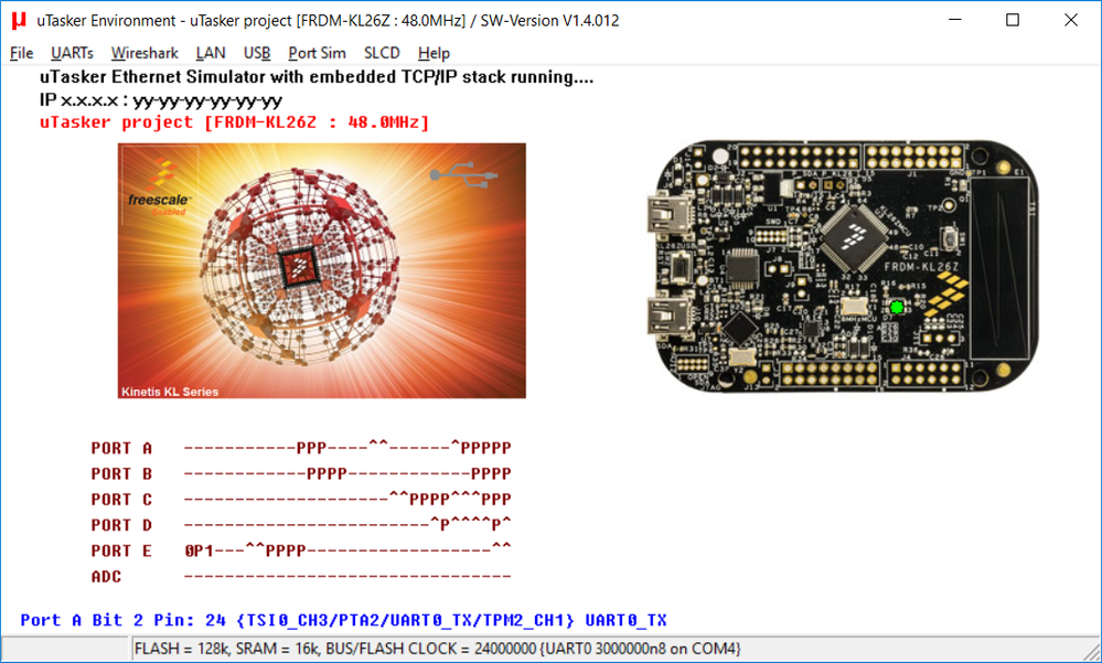

I know of no problems with the UART/DMA in the KL26.
Attached is a binary which you can load to the FRDM-KL26Z which will send a few hundred characters at 3MBaud out of the UART 0 every 50ms (visible also on J1-4 since it is too fast for the OpenSDA).
At the same time - it operates as USB-CDC (when connected by the KL26 USB connector) to show that both are possible in parallel (remembering that UART DMA and USB are both contending for the bus).
Below is the simulation where I also didn't see how DMA should be ale to fail:
Mark
