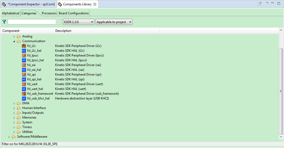

Could you guide me which component you are using to generate the SPI code?
Have you tried to prot the KSDK V1.3 <spi_dma_blocking_example_master> demo with your application?

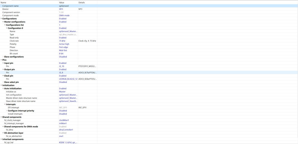

Also here are the settings I'm using in PE:
uint8_t spiTest[2]={0x80, 0x00};
uint8_t spiReadTest[2]={0x00, 0x00};
uint8_t spiTestBuffer[2]={0};
GPIO_DRV_WritePinOutput(J2_6,0);
spi_status_t spiReturnValue0=SPI_DRV_DmaMasterTransferBlocking(
  SPI1_IDX,
  &spiSensor2_MasterConfig0,
  spiTest,
  NULL,
  2,
1000
GPIO_DRV_WritePinOutput(J2_6,1);
spi_status_t spiReturnValuea=SPI_DRV_DmaMasterTransferBlocking(
  SPI1_IDX,
  spiReadTest,
  spiTestBuffer,
  2,
1000
2,352 Views
