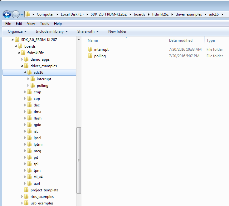

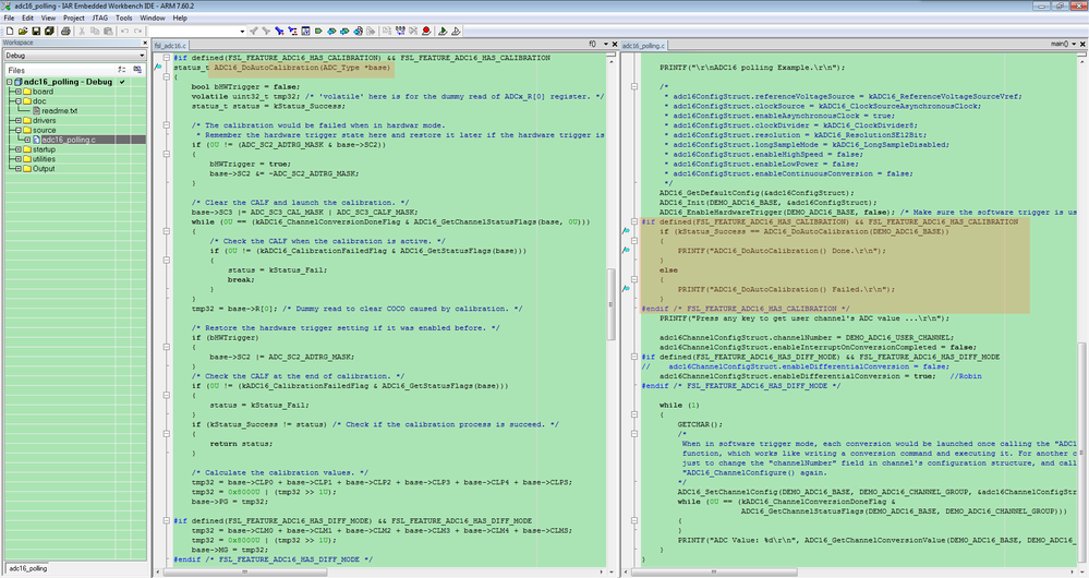

Robin_Shen
Hi Karen,
You can refer the ADC16_DoAutoCalibration function in KSDK2.0 for KL26.
I recommand you use the examples in KSDK2.0. (If you have not used it, please read Introducing Kinetis SDK v2 first.)
You can download and install it refer the methods in How to: install KSDK 2.0.
Robin
