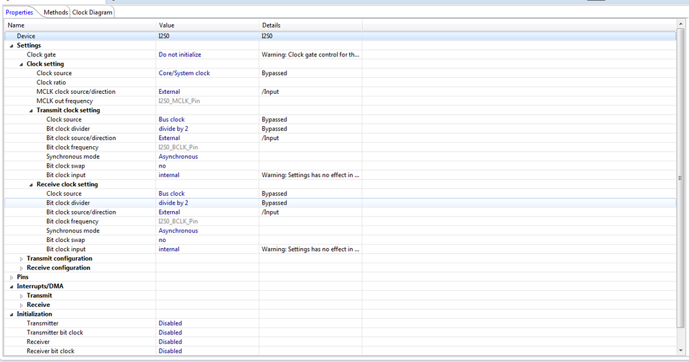

The Reference Manual for KL26 I2S port is unclear what to do with the clocks of the block that is in synchronous mode.

Helloo Jason,
- SAI_RX_SYNC is receive frame synchronization , connect to the SAI_TX_SYNC of other SAI interface .
SAI_RX_BCLK is the clock of receive bit , connect to the SAI_TX_BCLK of other SAI interface .
- About the configuration of SAI clock , please refer to : 5.7.10 I2S/SAI clocking of the KL26 reference manual.
configure the related registers .
And if you use the CW or KDS IDE, you can create one project with PE, then add the component "Init_I2S", configure the CLOCK:
Hope it helps
Alice

Hi Alice,
Thanks for your response.  My main question was if I want to master the SAI TX and slave the SAI RX to the SAI TX clocks, when I put SAI RX into Synchronous mode, do I have to physically route the SAI TX BCLK and FS to the SAI RX.  If not, I save 2 pins for other use.
I actually tried this out (had to make some mods to the SAI driver), and found that if SAI RX is in Synchronous mode, I do NOT have to physically drive SAI RX clocks.  That was good news.
