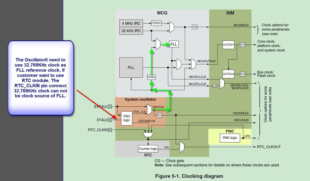

I am trying to get a KL26Z256VMC2 0N40H to use the RTC crystal as the clock source.
As far as I can tell the following process should do it, but it does not work for some reason.
The first step that goes wrong is when I attempt to set MCG_C7.OSCSEL to 1 (Selects 32 kHz RTC Oscillator - see KL26P121M48SF4RM KL26 Sub-Family Reference Manual, Rev. 3.2, October 2013).
When I attempt to view the register in a debugger, it is clear that the assignment has not worked.  Using the debugger to manually set the bit does not work either; it always reads as zero.
This has been ported from the K10 where it works successfully
1) Set the SIM_CLKDIV1 to configure the clock dividers: SIM_CLKDIV1 = SIM_CLKDIV1_OUTDIV1(0) | SIM_CLKDIV1_OUTDIV4(1);

7) Select the external RTC oscillator as the external clock source: MCG_C7 = 0x1;   *** This does not work on the KL26; reading back this register reveals that MCG_C7 remains 0 ***
8) Make sure FLL is selected: MCG_C6 = 0;
9) Configuring the clock source to be the external reference: MCG_C1 = 0;
10) Waiting to make sure that the external reference has been used (waiting for MCG_S.IREFST to become zero) *** The FLL never actually switches to use the external reference ***
11) Configure the FLL to use an appropriate multiplier from the default x640 and wait for the FLL lock time before continuing
I can not get the KL26 past the check in step 10.

2,979 Views
Hui_Ma
If customer want to use RTC and also use external RTC clock as FLL reference clock, customer need to use 32.768KHz connect to system oscillator0.
More detailed info, please check attached picture.
And I also attached an example about how to use 32.768KHz clock as FLL reference clock.
Wish it helps.

nurichard
For anyone interested:
The K10 and KL26 differ slightly in the working methods of configuring the RTC 32kHz oscillator.
The K10 allows you to use MCG_C7 to select the 32kHz RTC reference as a clock source (i.e. MCG_C2.EREFS0 == 0).
The KL26 doesn't seem to let you do this (despite the documentation for MCG_C7 being no different to the K10); you must configure it as an external crystal by setting MCG_C2.EREFS0 = 1
