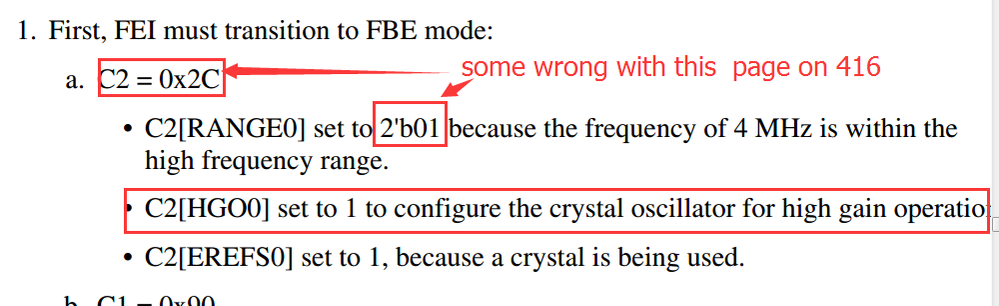

   I use keil5, I do clock init  .reference: "KL26P121M48SF4RM" of page on 416~418 24.5.3.1 Example 1: Moving from FEI to PEE mode: External Crystal =4 MHz, MCGOUTCLK frequency = 48 MHz
it running is ok ,but when I do debug,it is failed . it stopping " while((MCG->S & IREFST ) == 0x10U);"  I need you help. thanks

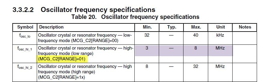

I tested the same on a FRDM-KL26Z and CodeWarrior and found the same behavior. I saw that the behavior is related with the wrong configuration of the MCG_C2 register. In your code you are configuring:
MCG_C2 = 0x1C which is:
RANGE0 = 01 Encoding 1 — High frequency range selected for the crystal oscillator .
EREFS0 = 1  Oscillator requested.
HGO0 = 1 Configure crystal oscillator for high-gain operation.
According to the DataSheet when RANGE0 = 01 the Oscillator must have a value of Min. 3 MHz and Max. 8 MHz. Since I am using the FRDM-KL26Z with an 8 MHz Oscillator I configured:
MCG_C2 = 0x24 which is:
RANGE0 = 1x Very high frequency range selected for the crystal oscillator
HGO0 = 0 Configure crystal oscillator for low-power operation.
Please check that the MCG_C2 value is configured correctly according to the Oscillator values in your hardware.

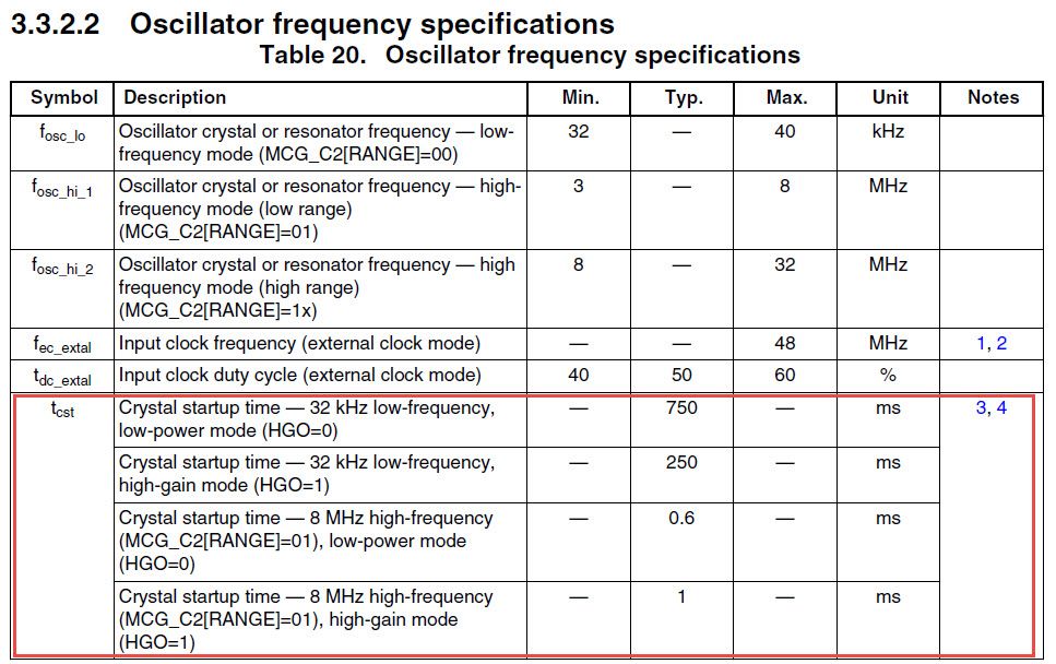

thank you . and I have some question abot HGO0 .why HGO0 = 0,  low-power or high-gain ,  high-gain have a good ?
1,948件の閲覧回数
adriancano
The different HGO modes can be used according to your hardware and project requirements. Please refer to the specific reference manual in the section High-Frequency, High-Gain Mode and section High-Frequency, Low-Power Mode to have a better understanding of each mode. As you can see in the Datasheet in the section Oscillation frequency specifications the HGO modes will impact directly in the Crystal startup time.
