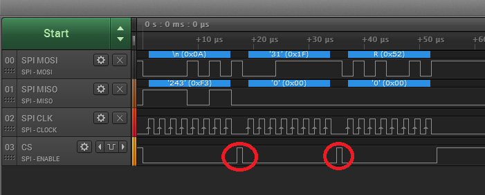

I am using SPI with DMA.
SPI_MasterGetDefaultConfig(&m_masterConfig);
m_masterConfig.outputMode = kSPI_SlaveSelectAutomaticOutput;
sourceClock = CLOCK_GetFreq(tSPI_ClockSource);
SPI_MasterInit(pBaseSPI, &m_masterConfig, sourceClock);
SPI_MasterTransferCreateHandleDMA(...
When the SPI bus transfers occur, the Chip Select is getting toggled between each byte. The toggling of the chip select does not work with my SPI slave (ADXL363 Accelerometer).
See attached image. How do I disable Chip Select toggling between bytes?

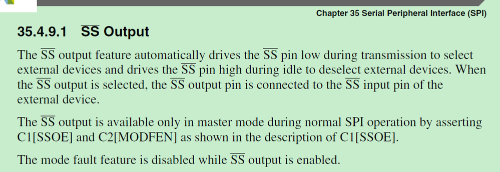

From KL16 reference manual chapter 35 SPI module description, there is no way to make /SS output continue low during communication. The /SS pin will back to high during idle status.
If customer want to use /SS always during SPI communication, customer can use a GPIO pin to emulate SPI chip select function.
Thank you for the attention.

bgraham
I have a hard time believing somebody designed SPI hardware with a chip
select toggle problem. The toggling problem will prevent 99.999% of all SPI
peripheral devices from working.
Was the chip select toggle problem caused by a incompetent MCU designer, or
can I by-pass the SPI APIs and turn off the screwed up toggling problem?
Bruce

Hui_Ma
I double check with Kinetis product team that KL16 SPI doesn't support chip select continue low during transfer.
It needs to use a GPIO pin emulate.
Thanks for the attention.
