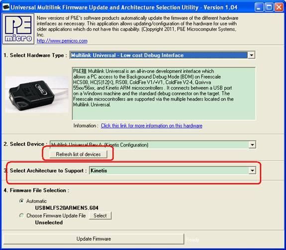

please also check if u-multilink firmware is the latest version for Kinetis device. Please use "Firmware Updates and Recovery" tool to update the firmware. (http://www.pemicro.com/osbdm/index.cfm ) You need connect U multilink with PC first:
