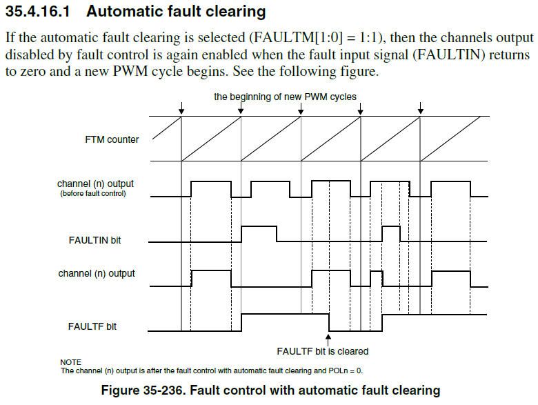

I am using the KL03s PWM outputs and I cannot determine if the channel outputs can be set low without disabling the PWM function.  For example, I would like the PWM to continue running and when an interrupt occurs I would like to turn the channel output off until the next cycle starts.

Hi Steven,
Do you mean the function like fault clearing? (for example: Automatic fault clearing)
The TPM module in KL03 doesn't support this function.
I am afraid you need select one MCU with fault inputs function. Product Selector can help you find the Kinetis with fault inputs function (PWM Types select Motor Control PWM).

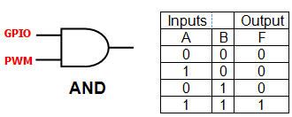

If you still want to use KL03, I think you can wire-AND the output of PWM and GPIO.
For example: Clear the GPIO after rising edge detected, set the GPIO in Timer Overflow Interrupt if needed.

stevengarfinkel
Thanks.  The feature you suggest is similar to what I had in mind.  I guess there is no register that actually represents the channel output in the KL03 family that could be reset in software.
