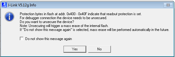

      Then, open dialog few times, it asks whether or not to release the security.
      As J-link Commander does not set the "Flash Mass Erase in Progreass bit", answer "No".
****** Error: Kinetis (connect): Failed to unsecure Kinetis device.

When  "open dialog few times, it asks whether or not to release the security", what exactly is the dialog that appears? It is like this:
If so, please click Yes at the first attend, because it will try to mass erase the internal flash and it should unsecure your device. You don't need to try to trigger a mass erase writing to the  "Flash Mass Erase in Progress" because if you click Yes it will automatically do all of this. Note: you need to click yes in the first attend because if you don't it will cause a error with the communication.
The flash configuration at 0x40D is related with the Flash nonvolatile option register and it shouldn't affect the secure byte, but the 0x40C is the Flash security byte, but you have it with 0xFE value that is mass erase enabled and MCU unsecure.
