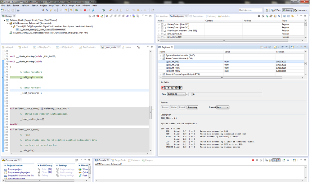

scottyevans
Hi Kerry
Sure, please see attached image. It is stopping right on __thumb_startup() as I mentioned before (no other breakpoints are set). it will only continue to run if I hit the "resume" button.
As you can see on the image, RCM_SRS0 indicates a reset was caused by a watchdog timeout on this particular instance, but the same happens if I did say an external reset pin.

kerryzhou
Hello Scott Evans,
   I understand you now.
   Actually, this is just the character of debugger, when the reset happens, it will stop after reset.
  But, after you download the code to your board, it will work normally after you feed the watchdog in time.
  You can download your code to your chip, and test the function without the debug.
  Please try it without the debugger again, whether your functions works, you can printf some data as the working log.
Wish it helps you!
