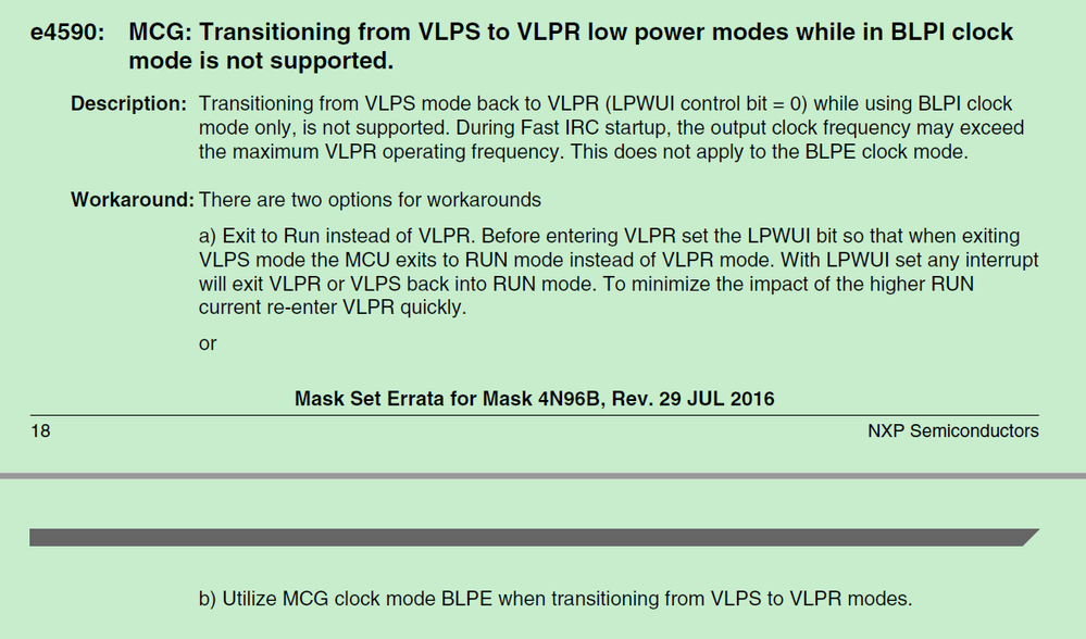

I have confirmed that the POR reset when WFI is happening. The system has been configured in VLPS and deepsleep is enabled in scr
Anyone has similar experience?
790 Views
Hui_Ma
There is an K70 errata record about VLPS wake up to VLPR mode while in BLPI clock mode:
Could you try to use the workaround way and check if there still with random POR issue or not?
