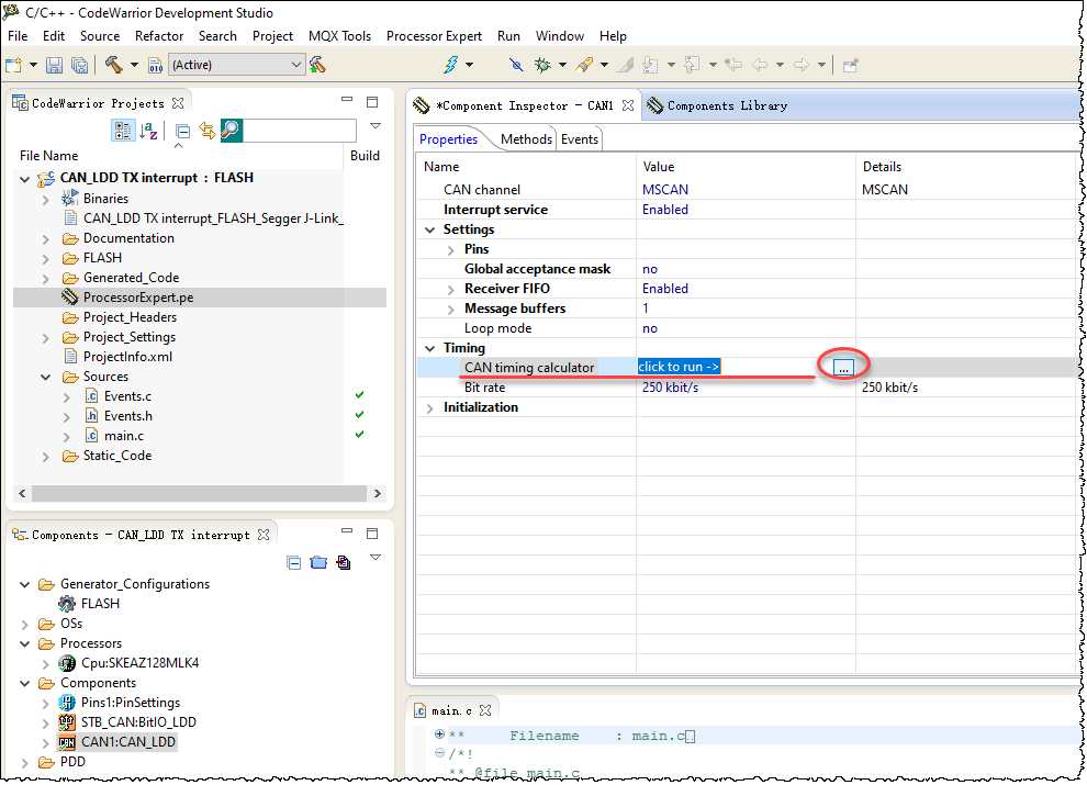

I am using kea128z using codewarrior Processor expert. When l configure the CAN bus bit rate to 250kbps, it automatically configured to 241.633kbps. But i want to run the CAN bus with 250kbps.
It might be happening due to Clock section, Please review the clock section also.
Please find the attachment of Processor expert generated code. This code is in running state with Tx_interrupt.

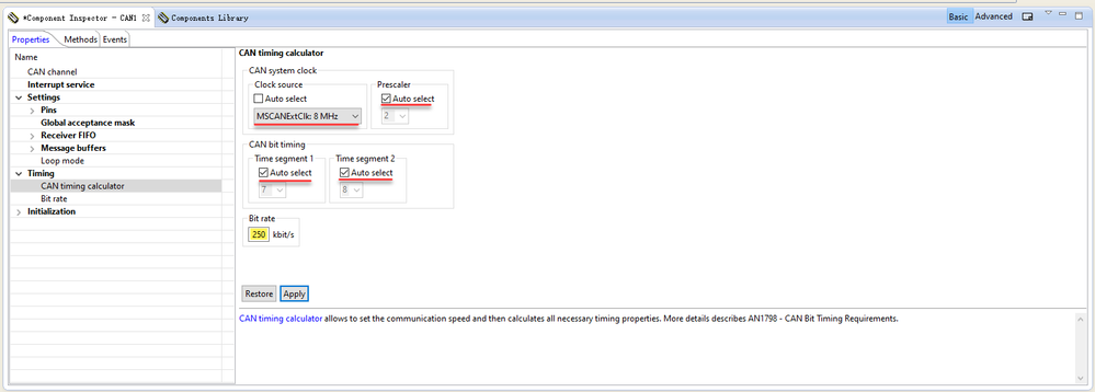

I forgot to configure 250 kbit/s with 8MHz crystal oscillator as an example.
You can use CAN timing calculator to achieve it.

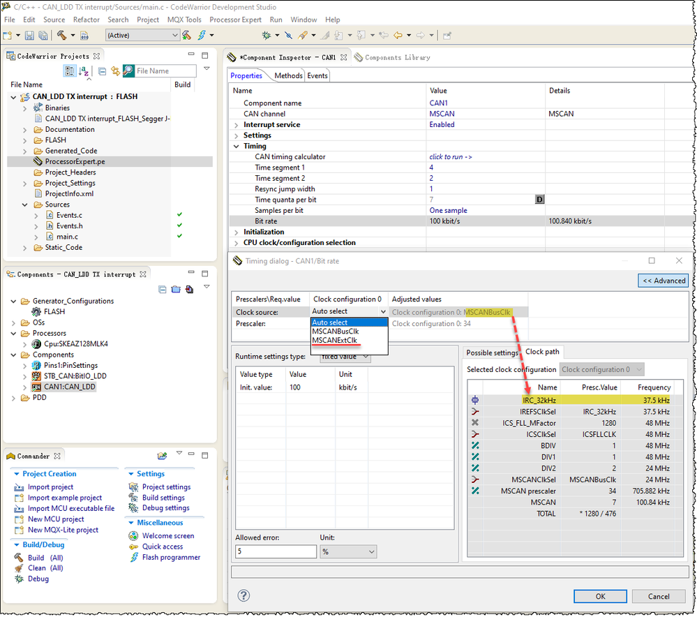

Hi rohit_rawat,
Please select MSCANExtCLK(8MHz crystal) as clock source of MSCAN instead of MSCANBusClk(37.5kHz IRC).
Robin

Dear sir,
After selecting MSCANExtCLK(8MHz crystal) as clock source of MSCAN, i am not able to set 250kbps bitrate for CAN. It shows "Timing setting failed - it is impossible to set the following items: selected value" error.
Please find the attachment.
