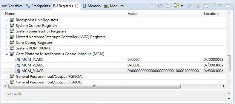

gusarambula
Thank you for posting the solution to this issue. If MCM_PLACR [ESFC] = 0 and at the same time all interrupts and sub-functions are in RAM this issue disapeared.

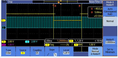

I do the similar test in my side, and just one case can get the same issue as you share, that is enable "ESFC" bit in MCM_PLACR, if this bit is set, then MCU is stall when EEPROM do sector erase, after clear this bit, it can work well.
Yellow is to indicate the status of the EEPROM sector erasing , when it is low, EEPROM sector erase is on-going.
and Blue is to use one timer to toggle one GPIO in its ISR.
also please refer to attached code, and when input 'y' with UART1, it will trigger the EEPROM sector erase one time.
so conclusion is it allow EEPROM sector erase and flash read operation simultaneous,however, please note if enable "ESFC" bit,  MCU will be stall when flash is busy.

mortyhsueh
Hi Ping,
Sorry for late reply.
I've checked the "ESFC" bit in MCM_PLACR in my project, it always kept "0", and the problem still persists.

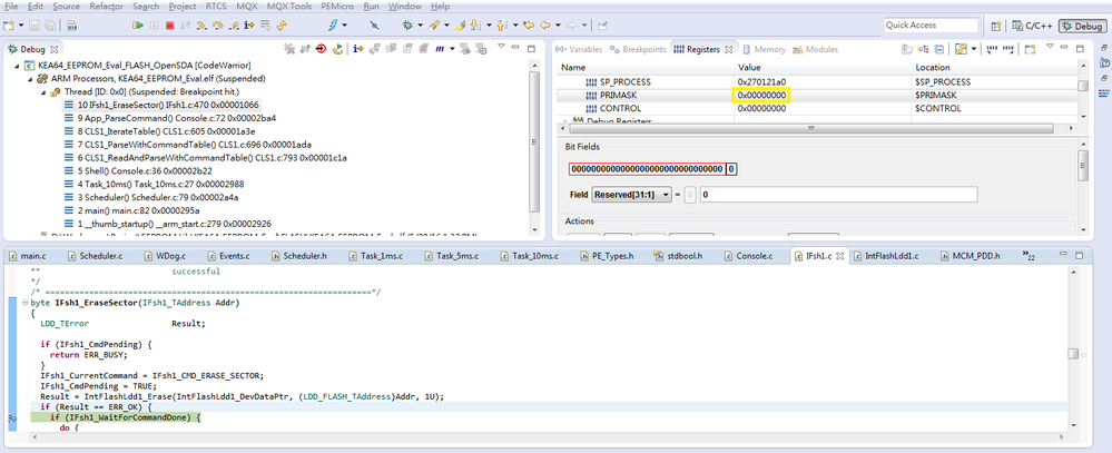

jeremyzhou
Hi Morty,
After had a brief look through the statement, I'd highly recommend that you can use the Step into feature to find out the code line that set the PRIMASK register. When set, it blocks all interrupt apart from the nonmaskable interrupt and the hard fault exception.
Hope it helps.
Ping
9,884 Views
mortyhsueh
Hi Ping,
Thanks for your suggestion, I 've used Step info to check the PRIMASK register, but no bit set. Erase.png
Besides interrupt, all process suspends until erasing complete.
I realize that there is only one flash controller in KEA64. EEPROM are also controlled by the flash controller.
Is it possible that all process is halted by the controller during EEPROM sector erasing?
Morty

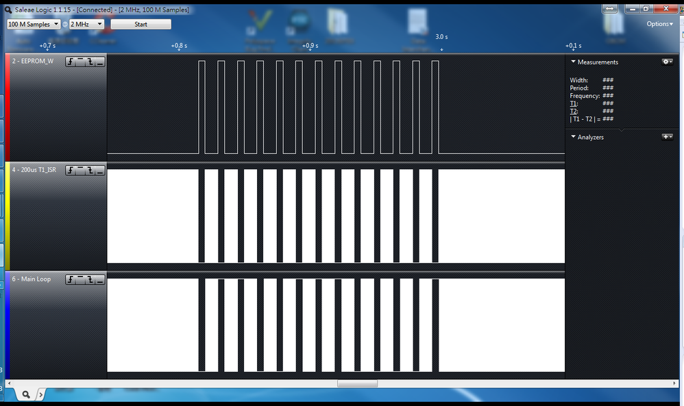

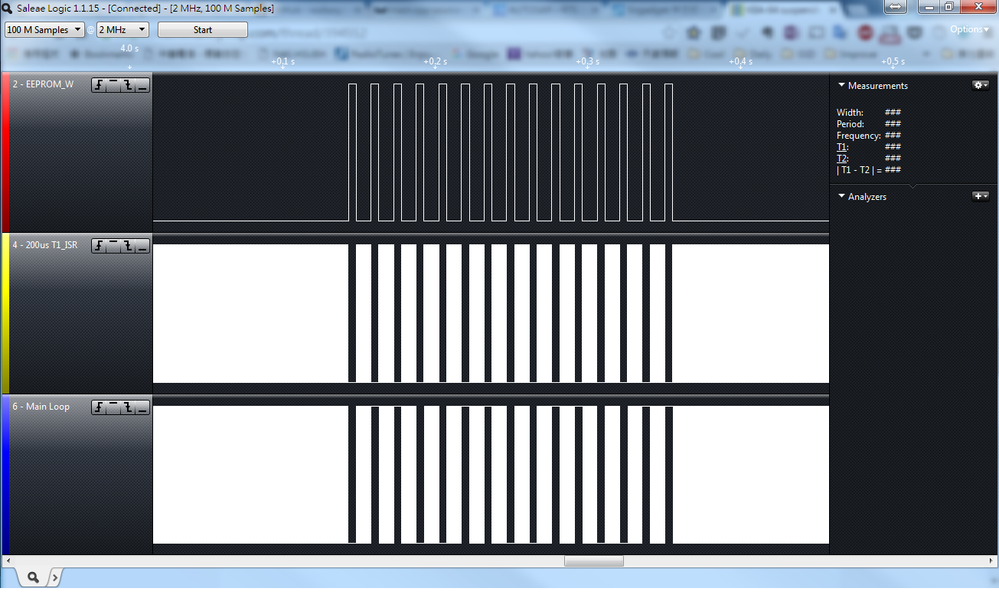

mortyhsueh
Hi Ping,
Thanks a lot!
For reproducing this problem, I used TRK-KEA64 EVB and created a simple example which all components are created by Processor Expert. Besides, I also captured the waveform for your reference.
Configuration of the example on TRK-KEA64 EVB is listed as below.
EEPROM erasing is triggered by pushing "Button 0" on EVB.
  1. I/O LED 1 level high presents the EEPROM is erasing.
  2. I/O LED 2 toggling presents the 200us ISR is active.
  3. I/O LED 3 toggling presents the main loop is active.
According to the experiment, I suspected 200us periodic ISR and main loop are blocked by the EEPROM erasing.
I've done the same experiment on MC9S12XDG128, but everything is good.
Thanks again for your great help, the source code is attached.
