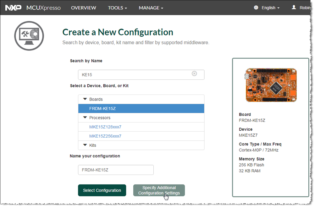

On the NXP's official website,the demo of KE15Z FRDM is false.For example,the package of the latest ksdk 1.3.0 does not contain anything about KE15Z,and the video of the demo is irrelevant with KE15Z FRDM。
835 Views
Robin_Shen
Hi aline,

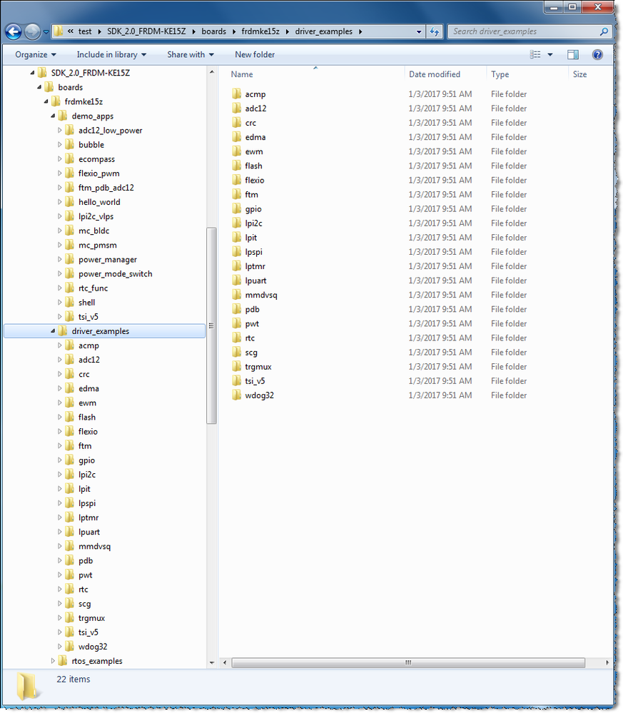

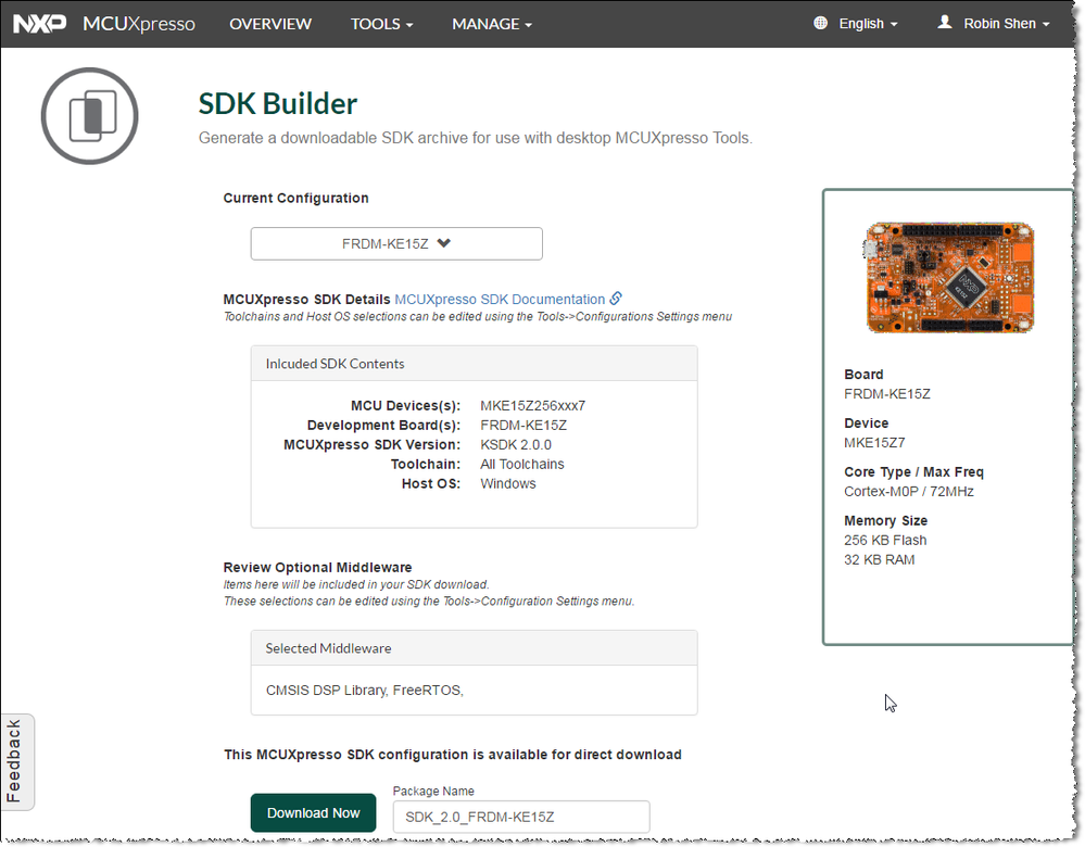

Please refer the examples in SDK_2.0_FRDM-KE15Z.
Select FRDM-KE15Z then download SDK_2.0_FRDM-KE15Z.
You can getting start with KSDK reading "How to start with KSDK".
