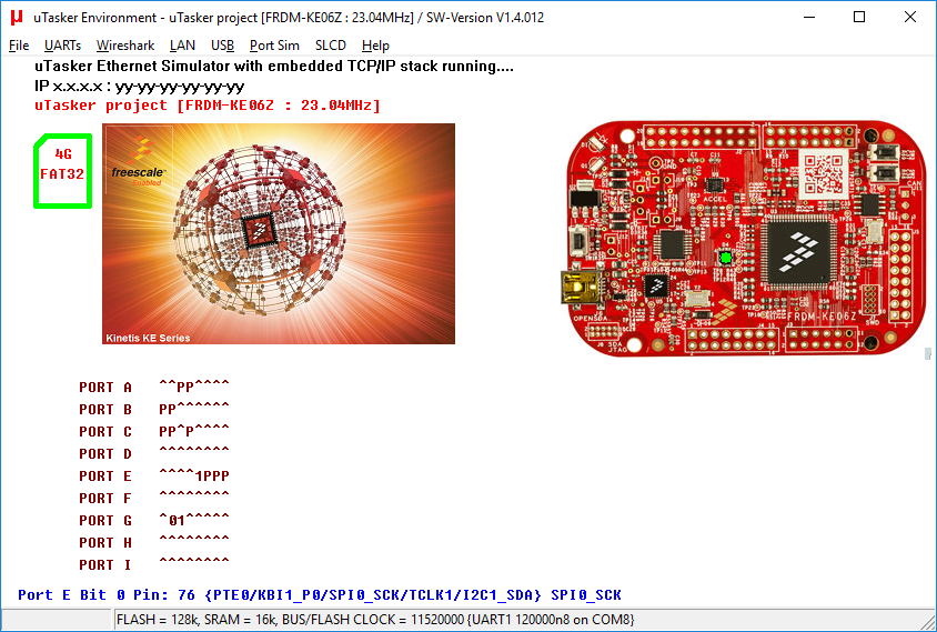

I simulated your 18.432MHz crystal and divider settings in the uTasker KE06 simulator and didn't see any problems.
The core clock is 23.04Mhz and bus/flash 11.52MHz (see below)
Since you are not changing any divider values between crystal frequency changes I would suspect the oscillator configuration.
Take a look at the code that is generated in the two case and see which value it sets to OSC_CR. Check that it correctly selects the high range and also that it consistently selects the high gain setting according to your HW needs.
Mark
