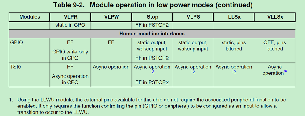

Please check below table about  modules working status at different low power mode:
The GPIO module doesn't work during LLSx and VLLSx low power mode.
So, there only support edge trigger with LLWU module at LLSx and VLLSx low power mode.
Wish it helps.
