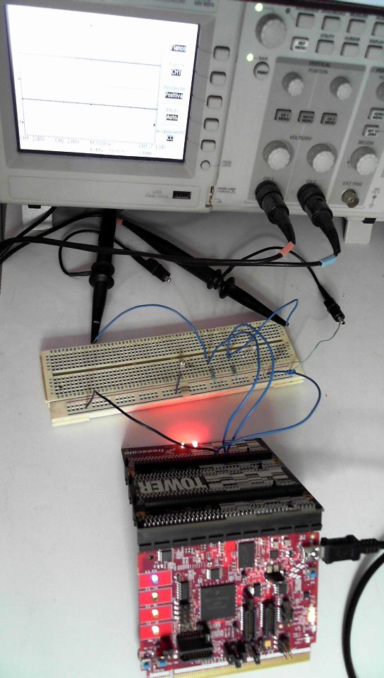

Hello. I've been trying (for almost 2 months) to set the LCDC module of the TWR K70 board with no succes. I need to display a number in a plain VGA PC monitor connecting the VGA DB-15. connector in a board.
I am trying first to get the signals out of the k70 but nothing... I don't even see the Hsync or Vsync signals.
This is my program, it is just configuration to turn on the LCDC but nothing, what is wrong? Programm is full of comments since I am learning and reading the data sheet and getting the elements I need to complete the project I am working for, so I am sorry because it is quite messy but Looks like I am very near of the goal.
Here is my set up, the board, getting out the H & V signals to the oscilloscope of the elevator connector but nothing.
HELP PLEASE!!!

LuisCasado
Hello Oliver,
You can check in the SC code, the example for the TWR-K70 (lcdc project)
KINETIS_120MHZ_SC   : Kinetis 120MHz bare metal sample code.
Size (K): 17844 Format: zip Rev #: 1.4 Modified: 12/19/2013
By default the MPU is enabled and the LCDC can’t access to the DDR (frame buffer). You need to disable it completely or configure the MPU registers. For testing add:
    /* Disable MPU */
    MPU_CESR &= ~MPU_CESR_VLD_MASK;
But review the SC code project just in case you are missing other configuration.
Luis
2,770 Views
olivergonzalez
Hello Luis.
I downloaded the SC code, I changed to a new version and I've been trying to make the LCDC module to work and it is still the same, no Vsync or Hsync signals out of the ports...
This is my new code, it is practically the same provided by the SC and it is not working. What can I do? Who can help me with this?

  PORTF_PCR4 =ALT7; // Graphic LCD D[0],  Schematic PTF4
  PORTF_PCR5 =ALT7; // Graphic LCD D[1],  Schematic PTF5
  PORTF_PCR6 =ALT7; // Graphic LCD D[2],  Schematic PTF6
  PORTF_PCR7 =ALT7; // Graphic LCD D[3],  Schematic PTF7
  PORTF_PCR8 =ALT7; // Graphic LCD D[4],  Schematic PTF8
  PORTF_PCR9 =ALT7; // Graphic LCD D[5],  Schematic PTF9
  PORTF_PCR10=ALT7; // Graphic LCD D[6],  Schematic PTF10
  PORTF_PCR11=ALT7; // Graphic LCD D[7],  Schematic PTF11
  PORTF_PCR12=ALT7; // Graphic LCD D[8],  Schematic PTF12
  PORTF_PCR13=ALT7; // Graphic LCD D[9],  Schematic PTF13
  PORTF_PCR14=ALT7; // Graphic LCD D[10], Schematic PTF14
  PORTF_PCR15=ALT7; // Graphic LCD D[11], Schematic PTF15
  PORTF_PCR16=ALT5; // Graphic LCD D[12], Schematic PTF16
  PORTF_PCR17=ALT5; // Graphic LCD D[13], Schematic PTF17
  PORTF_PCR18=ALT5; // Graphic LCD D[14], Schematic PTF18
  PORTF_PCR19=ALT5; // Graphic LCD D[15], Schematic PTF19
  PORTF_PCR20=ALT5; // Graphic LCD D[16], Schematic PTF20
  PORTF_PCR21=ALT7; // Graphic LCD D[17], Schematic PTF21
  PORTF_PCR22=ALT7; // Graphic LCD D[18], Schematic PTF22
  PORTF_PCR23=ALT7; // Graphic LCD D[19], Schematic PTF23
  PORTF_PCR24=ALT7; // Graphic LCD D[20], Schematic PTF24
  PORTF_PCR25=ALT7; // Graphic LCD D[21], Schematic PTF25
  PORTF_PCR26=ALT7; // Graphic LCD D[22], Schematic PTF26
  PORTF_PCR27=ALT7; // Graphic LCD D[23], Schematic PTF27
  PORTF_PCR0=ALT7;  // Graphic LCD PCLK,  Schematic PTF0
  PORTF_PCR1=ALT7;  // Graphic LCD DE,    Schematic PTF1
  PORTF_PCR2=ALT7;  // Graphic LCD HSYNC, Schematic PTF2
  PORTF_PCR3=ALT7;  // Graphic LCD VSYNC, Schematic PTF3
  // set LCD_CONTRAST
  //PORTB_PCR4=ALT2;  // Graphic LCD CONTRAST,  Schematic PTB4
void lcdc_init_screen()
  // set LCD Screen Start Address
  LCDC_LSSAR = FRAME_START_ADDRESS;
  // set LCD Size. The XMAX bitfield is the screen x-size/16.
  LCDC_LSR = LCDC_LSR_XMAX( (SCREEN_XSIZE / 16) ) | LCDC_LSR_YMAX( SCREEN_YSIZE );
  // set LCD virtual page width
  LCDC_LVPWR = LCDC_LVPWR_VPW( SCREEN_XSIZE );
  // set LCD cursor positon & settings (turn off)
  LCDC_LCPR = 0;
  LCDC_LCWHB = 0;
  // set LCD panel configuration. Use endianess to work with TWR-LCD-RGB lines.
  LCDC_LPCR =
    LCDC_LPCR_TFT_MASK      |       //TFT Screen
    LCDC_LPCR_COLOR_MASK    |       //Color
    LCDC_LPCR_BPIX(0x2)     |       //4 bpp
    LCDC_LPCR_FLMPOL_MASK   |       //first line marker active low (VSYNC)
    LCDC_LPCR_LPPOL_MASK    |       //line pulse active low (HSYNC)
    LCDC_LPCR_END_SEL_MASK  |       //Use big-endian mode (0xFFAA5500 means R=AA,G=55,B=00).
    //LCDC_LPCR_SWAP_SEL_MASK |       //Set if needed for LCD data lines match up correctly with the LCD
    LCDC_LPCR_SCLKIDLE_MASK |       //Enalbe LSCLK when vsync is idle
    LCDC_LPCR_SCLKSEL_MASK  |       //Always enable clock
    LCDC_LPCR_PCD(11);             //Divide 120 PLL0 clock (default clock) by (11+1)=12 to get 10MHz clock
//If RevE or later TWR-LCD-RGB, need to adjust clock settings
#ifdef REVE
  LCDC_LPCR |= LCDC_LPCR_CLKPOL_MASK;    //In TFT mode, active on negative edge of LSCLK.
  // set LCD horizontal configuration based on panel data (Figure 3-3 in Seiko datasheet)
  LCDC_LHCR =
    LCDC_LHCR_H_WIDTH(41)   |    //(41+1)=42 SCLK period for HSYNC activated
    LCDC_LHCR_H_WAIT_1(1)  |    //(1+1)=2 SCLK period between end of OE and beginning of HSYNC
    LCDC_LHCR_H_WAIT_2(0);     //(0+3)=3 SCLK periods between end of HSYNC and beginning of OE
  // set LCD vertical configuration based on panel data (Figure 3-3 in Seiko datasheet)
  LCDC_LVCR =
    LCDC_LVCR_V_WIDTH(2)  |   //2 lines period for VSYNC activated
    LCDC_LVCR_V_WAIT_1(1) |    //1 line period between end of OE and beginning of VSYNC
    LCDC_LVCR_V_WAIT_2(1);    //1 line periods between end of VSYNC and beginning of OE
//Earlier TWR-LCD-RGB versions (B, C, and D)
#else
  LCDC_LHCR =
    LCDC_LHCR_H_WIDTH(40)   |    //(40+1)=41 SCLK period for HSYNC activated
  LCDC_LVCR =
    LCDC_LVCR_V_WIDTH(10)  |   //10 lines period for VSYNC activated
    LCDC_LVCR_V_WAIT_1(2) |    //2 line period between end of OE and beginning of VSYNC
    LCDC_LVCR_V_WAIT_2(2);    //2 line periods between end of VSYNC and beginning of OE
#endif
  // set the LCD panning offset (not used in 24bpp mode)
  LCDC_LPOR = 0;
  // set LCD interrupt configuration register
  LCDC_LICR = 0;
  //Disable LCDC interrupts
  LCDC_LIER = 0;
  //Disable the graphic window. See the "color" and "fsl" demos for examples of
  //  using the graphic window feature
  LCDC_LGWCR &=~LCDC_LGWCR_GWE_MASK;
  //Set background plane DMA to burst mode
  LCDC_LDCR&=~LCDC_LDCR_BURST_MASK;
  //Set graphic window DMA to burst mode
  LCDC_LGWDCR&=~LCDC_LGWDCR_GWBT_MASK;
2,770 Views
melissa_hunter
Hi Oliver,
I found a number of issues with your code.....
1. What clock mode are you using? Looks like you have disabled the PLL or at least zeroed out the dividers. Was that intentional? The SIM_SOPT2[LCDCSRC] configuration you have is trying to use the MCGPLL0CLK as the source, so you either need to have a valid PLL0 configuration or change the LCDCSRC setting. Right now you don't have a valid clock input to the LCD.
2. What memory location are you using to store the graphic buffer? For the screen size (800x600) and configuration you are using (4bpp), you need 240KB of memory to store the image. This is larger than the on-chip RAM, so you'll need to have some external memory configured and accessible for the image. The LSR and LVPWR settings you are using are also incorrect. The LSR should be 0x03200258 for an 800x600 screen (yes, you should be dividing the XSIZE by 16. The LVPWR should be 100 for your configuration (800 pixels with 4bpp, means you need 100 32-bit values to store a line of data).
3. The LPCR[PCD] should be 2 or larger for a TFT configuration. Minimum valid divide is 3 for TFT mode. You should still be able to get signals with the incorrect divider, but you should still address this problem.
4. The LRMCR value you have is enabling self refresh mode. You don't really want that on.
5. You have the graphic window enabled (LGWCR[GWE] set). It doesn't look like you actually have an image for the graphic window (LGWSAR = 0), and you don't have the data lines on at this point anyway. You should probably disable the graphic window. Basically you can just skip writing any of the LGWxx registers. The graphic window is disabled by default.
I hope this helps to get you up and running.
Melissa
