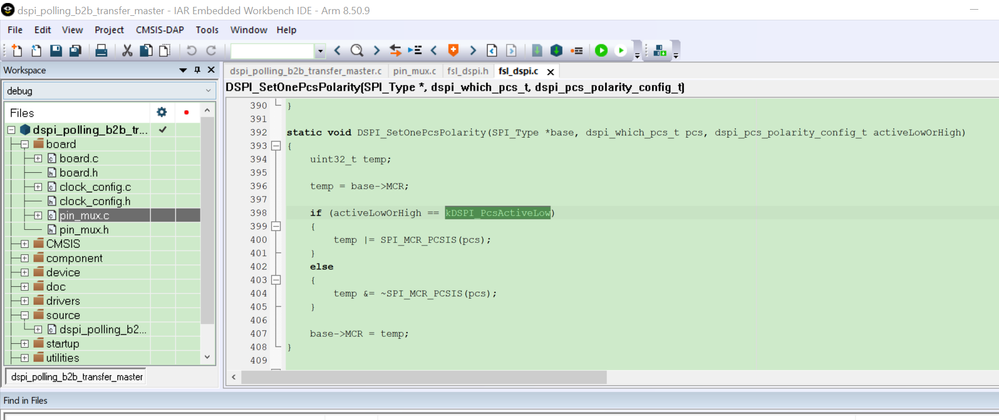

The SDK code implies PCSIS is a bitfield, and that the documentation quoted above is incorrect:
typedef enum _dspi_which_pcs_config
    kDSPI_Pcs0 = 1U << 0, /*!< Pcs[0] */
    kDSPI_Pcs1 = 1U << 1, /*!< Pcs[1] */
    kDSPI_Pcs2 = 1U << 2, /*!< Pcs[2] */
    kDSPI_Pcs3 = 1U << 3, /*!< Pcs[3] */
    kDSPI_Pcs4 = 1U << 4, /*!< Pcs[4] */
    kDSPI_Pcs5 = 1U << 5  /*!< Pcs[5] */
} dspi_which_pcs_t;

   To K64 SPI, it contains 6 PCS: PCS0-PCS5.
   The K64 RM SPIx_MCR[PCSIS] description is correct, PCSIS has 6bits, from bit 16 to bit21.
   It means bit 16 to bit 21 is related to the PCS0-PCS5.
   Please note, document mentioned inactive state, but the SDK mentioned active state.
  You also can find details in the SDK, eg:
#define SPI_MCR_PCSIS(x) (((uint32_t)(((uint32_t)(x)) << SPI_MCR_PCSIS_SHIFT)) & SPI_MCR_PCSIS_MASK)
kDSPI_PcsActiveHigh = 0U, /*!< Pcs Active High (idles low). */
kDSPI_PcsActiveLow = 1U /*!< Pcs Active Low (idles high). */
You can find, when kDSPI_PcsActiveLow=1, then the code set related PCS bit to 1, it is also the inactive state of PCSx is high, means active state is low. Then the related PCS pin will be configured.
In fact, the RM is correct.
SPIX_MCR[PCSIS]: define the related PCS bit active is high or low, it is not determined used or not.
SPIx_PUSHR[PCS]: you can understanding it is used to determined the SPI data transfer is assert the PCS[x] or not.
Take the SDK code as example:
base->PUSHR = SPI_PUSHR_CONT(command->isPcsContinuous) | SPI_PUSHR_CTAS(command->whichCtar) |
SPI_PUSHR_PCS(command->whichPcs) | SPI_PUSHR_EOQ(command->isEndOfQueue) |
SPI_PUSHR_CTCNT(command->clearTransferCount) | SPI_PUSHR_TXDATA(data);
This means, this SPI transfer will use the related PCS pin, still the same, PCS in PUSHR is bit 21-16, it means PCS5-0.
So, no matter the SDK or the RM document, all correct. Just one is configure the active low or high, another is used to insert the related PCS pin function or not.
