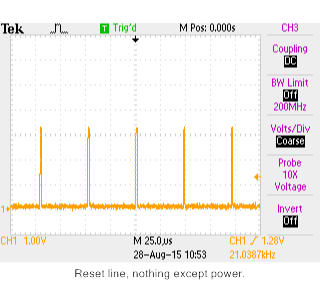

I made my own custom board using the MK64FN1M0VLL (same as on the Freedom K64F Mbed board) but I am having issues with flashing it (K64F not seeming to reply to any SWD commands). I have a feeling this is happening because the micro controller is not being correctly put and kept in a reset state when it should during SWD communications. To be clear, this is an un-programmed K64F fresh from the factory.
Below is the reset line when power is applied to the K64F. The line going high seems to make sense based on the MCU resetting itself due to as I understand this post here.

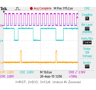

And here is me running an "unlock Kinetis" command in J-Link commander. Shouldn't reset be held low during this time?
There is a 50 uS gap between every 1.5 uS long spike at 3.3v.

And the zoomed in initial 3 dips on the SWD_DIO line:
