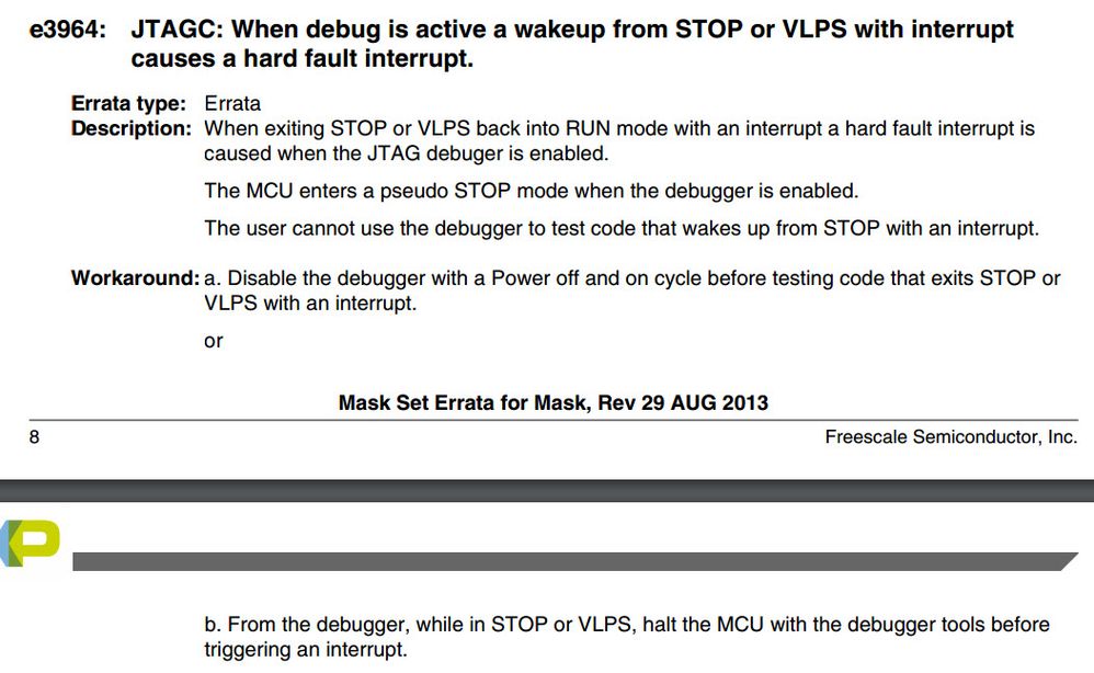

3,282 Views
Hui_Ma
Hi Evgeni,
1. For there with the errata e3964 shows:
The MCU enters a pseudo STOP mode when the debugger is enabled.
I don't recommend customer to debug the system with STOP mode, which is a pseudo STOP mode.
2. Yes, customer can modify the JTAG pins with GPIO function before enter into the STOP mode to disable the debugger connection.
Wish it helps.
Ma Hui

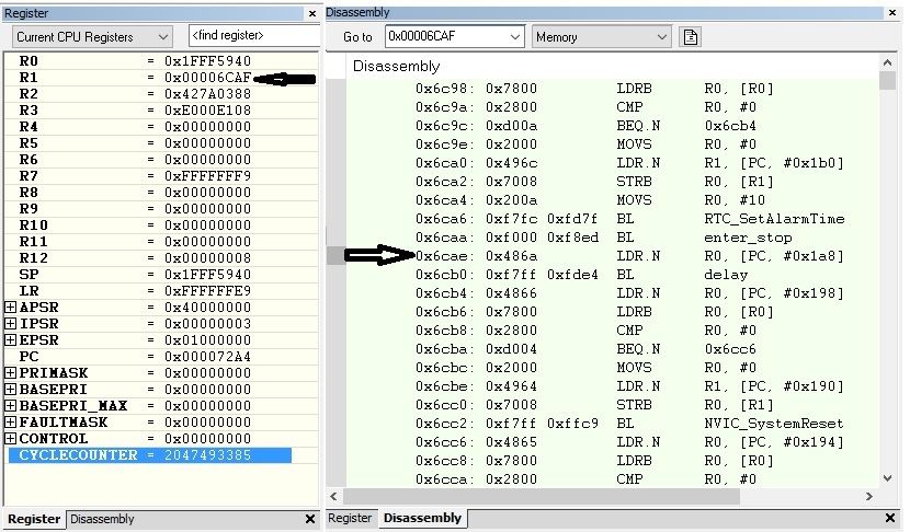

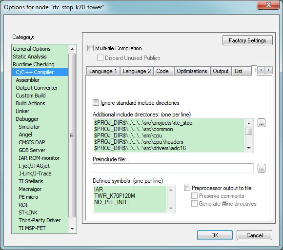

evgenik
Hi.
1. The value of SCB_CFSR register is 0x00000100.
2. I checked where from occurred HardFault_Handler(). It occured into enter_stop()-> asm("WFI") instruction:
3. I tried to work without PLL (as you described ) with NO_PLL_INIT. All work without crash but without PLL. and external oscillator. On wake up what_mcg_mode() return mode = 3.
4. How can I on wake up reconfigure PLL use? When I work with PLL on wake up what_mcg_mode() return mode = 8.
Thanks a lot.
Evgeni

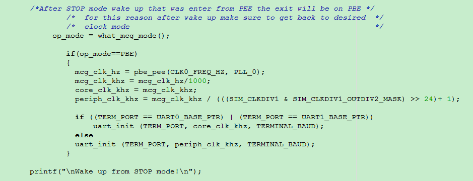

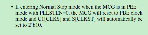

Hui_Ma
Hi  Evgeni,
I checked with K70 errata file (mask set 4N96B) with below errata info:
So, during my test again, I did not connect the debugger tool. Or even did not using the on board OpenSDA tool.
Just using the tower elevator board provide power.
Then, I could find there without hard fault exception any more.
I also checked the K70 reference manual with below note:
So, I modify the test routine add below code after wake up from stop mode:
With above code, the UART baud rate will back to correct baud rate and did print the correct characters at terminal.
I attached my updated test code for your reference.
BTW: There did not need to disable K70 MPU, please comment below code:
//MPU_CESR &= ~MPU_CESR_VLD_MASK;
Wish it helps.
Ma Hui

Hui_Ma
1. Could you provide the SCB_CFSR register value when hard fault exception happens?
2. The system clock doesn't back to PEE mode correctly cause the UART baud rate inaccuracy.
    Customer could check to call  what_mcg_mode() function in <mcg.c> file. If the MCG not works in PEE mode, there need to re-initialize the MCG into PEE mode again.
Wish it helps.
Ma Hui
