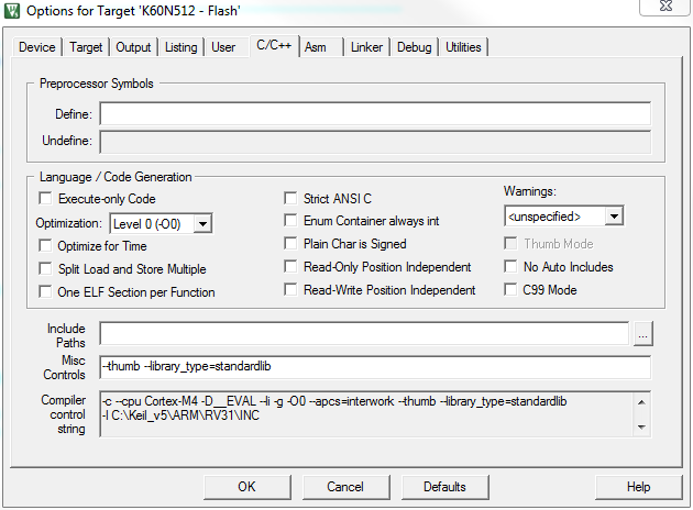

did you add the compiling options as below?
Actually I did the same to the Blinky project in the folder of "C:\Keil_v5\ARM\Boards\Freescale\TWR-K60N512\Blinky", and tested it with TWR-K60N512, but seems it works well as expected.
Would you please help to confirm if I missed something else?

erickcastillo
Hi Kan,
Thanks for checking this out.
I took your lead and decided to try out my methods with the blinky project. I even made the linker do what I do on my Eclipse build (adding ARM_LIB_HEAP and ARM_LIB_STACK in the scatter file) and everything appears to work fine. I could step through the library scatter loading disassembly and Blinky runs fine in uVision. I will look more closely at my Eclipse build options and compare them to blinky and see what I find. It may even be related to the IDE; who knows? I'll post an update once I have one.
