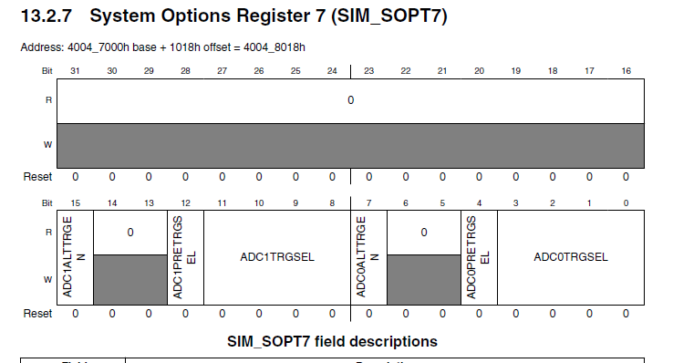

xiangjun_rong
Hi, Scott,
I suppose that you use PIT module to generate PIT interrupt, in the PIT ISR, start ADC conversion of K26, and you use ADC interrupt mode, in the ADC ISR, read ADC samples. You want to sample analog signal with fixed cycle time, but you find that the ADC ISR happens with jitter. I have to admit that the fixed sampling cycle time can not be guaranteed if you use software triggering ADC mode.
I suggest you use hardware ADC triggering mode, the hardware triggering mode can guarantee the fixed sampling cycle time, in other words all samples are acquired with same interval, if you use ADC interrupt mode to read ADC samples, it is okay even if the ADC interrupt has jitter, the hardware triggering mode can guarantee that there is not any jitter for the sampling interval.
Regarding the ADC hardware triggering source sleection, pls refer to the SIM_SOPT7 in RM of K26.
Hope it can help you
