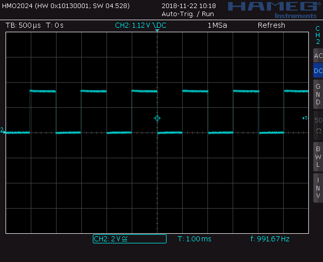

Device is MK22FN256VLL12, the LPTMR is currently using the LPO (1 kHz) with prescaler bypassed, running in time counter mode. What I am experiencing is about 2 ms overhead regardless of CMR value, e.g. until TCF is set. I check the LPO on PTE0 using the following setup:
SIM->SOPT1 |= SIM_SOPT1_OSC32KSEL(3) | SIM_SOPT1_OSC32KOUT(1);
The waveform looks as follows:
So about 1% slower, which is well within acceptable.

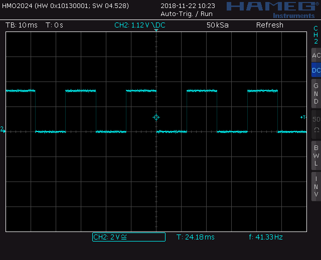

This is just called from main. The ONLY other ISR running at 20 ms intervals is the SysTick ISR, which just increases a counter and nothing else. The results when monitoring PTE0 using a scope, is as follows:
So what ought to be 10 ms toggle intervals is now approximately 12 ms intervals.
Any suggestions why I have an overhead of 2 ms and what I've misunderstood about the LPTMR?

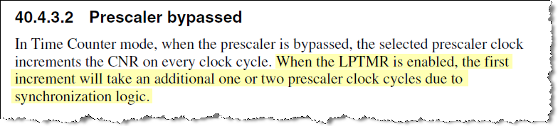

According to my understanding: When 1kHz LPO is used, LPTMR0->CMR=0x09 will lead 10ms timeout.
Additionally: When the LPTMR is enabled, the first increment will take an additional one or two prescaler clock cycles due to synchronization logic.
