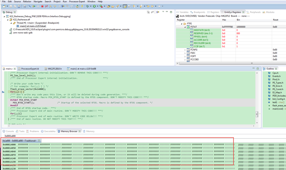

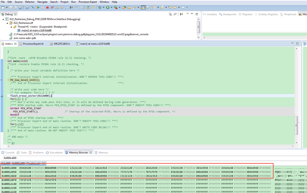

  I create a KDS project, and do the sector erase with your code, it works ok on my side.
Before erase, 0X0001A000  have data:0x00-0xff
After sector erase, the address 0x0001a000 can be erased, the ACCERR is not set:
