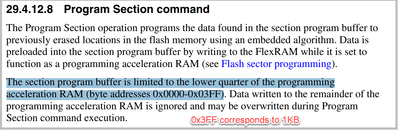

According to below snaps from the MK21  RM, the FlexRAM  section program buffer will hold up to 1 KB of data for the program section command. I think that you mentioned that you are trying to write 0x1000 bytes , or 4KB.

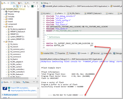

I am mentioning this , as I  have been running the MCUXpresso SDK pflash demo  with specific modifications to pflash.c on my K64F: (as I do not have any MK2x board with me during this Corona virus lock down)
1 Use your address of 0x5000
2 Use the FLASH  function for  program section command, not program  FLASH_Program. If we leave that last one, we can program 4KB. If I am not wrong , that function  programs each 8 bytes, using like your current workarround, the  program phase command.
3 Play with the length of the dummy buffer that the demo uses for writing in to the flash. As it is expressed in 4 byte words, that 256 corresponds to 1KB.
Below , find my relevant test results:
A) Using  1 KB  for buffer length,  no errors, see console results:
B) Using more than 1 KB, or 4 KB , we have flash errors
In particular the below  error corresponds to when I used a buffer with a length of 4 Kb.
The FTFx_FSTAT_ACCERR_MASK error is raised.
Therefore , my recommendation is to test program section command for 1 KB and check our MCUxpresso SDK pflash examples and use latest MK21 flash driver. This can be found at MCUxpresso SDK builder. I have mentioned the TWR-K21 Plash example as uses a similar MK21.
