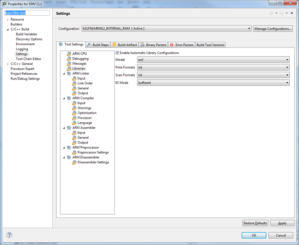

Kevin, by any chance did you remember to change the CPU preprocessor definition in your project's C build settings?  For example:

Hello Kevin Le Dinh:
If the watchdog is enabled it may be that the project is using one of the CodeWarrior semihosting libraries. Please check the next discussion about this issue:
Re: MK10DX256VLK7 doesn't run standalone, just when debugging. Verified it's running from FLASH, not...
Otherwise please let us know the full part numbers of your K21 and K60 and if possible share the project so I can give it a check from my side.

Thanks for your reply. The watchdog is disabled and I'm not using any semihosting libraries as described. I am debug printf through UART.
The full part number is K21FN1M0VMC12 and K60DN512ZVLL10. I want to convert from a K60 project to K21. Is there any safe way to share the project with you?
An update to the problem. When I make some changes to the code and debug on the target, the hardfault handler is triggered. Looking closely at the handler, there is a bus fault and the rogue address is saved in the Bus Fault Address Register (BFAR). This address is assigned as a value to a pointer variable in my code.
