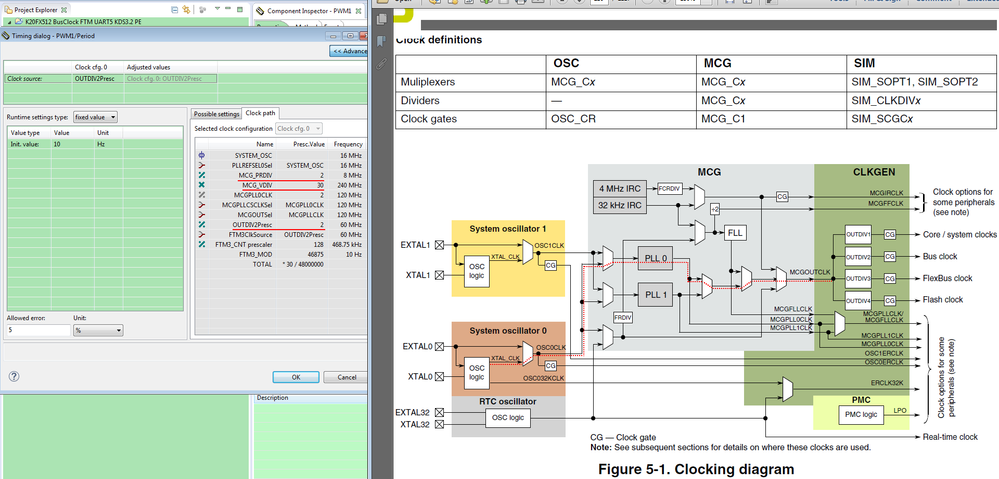

Please observe the values of SIM_CLKDIV1\ MCG_C5\ MCG_C6 when debugging. The Divide Factor and Multiply Factor should equal the values in below image.
Have you tested the project generated by ProcessorExpert? Will the FlexBUS clock on PTC3 change if you only change the Oscillator operating mode?
I don't have K20FX512, so I test it on TWR-K60F120M board.
Changing the the Oscillator operating mode will not change the FlexBUS clock on PTC3(or period of PWM) on my board. But I am using "System oscillator 1", there is a 12MHz crystal connected on it.
