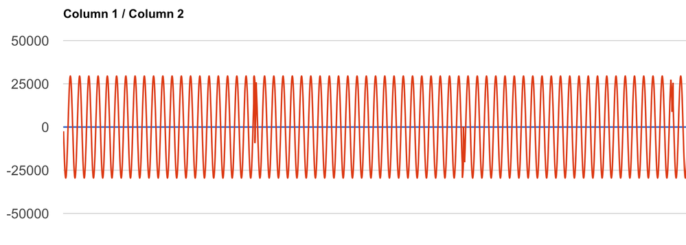

I am working on a custom K20 based board (MK20DX256) trying to output a sin(x) wave via i2s/sai. My custom board is pretty spartan, 16mhz crystal, the K20 and a codec hooked up via i2c and i2s. I'm using a SEGGER JLink to flash the K20. I'm using KDS 3.0, MQX Lite and processor expert, however I'm using raw PDD calls rather than components for the i2s and DMA to better understand the code I'm writing.

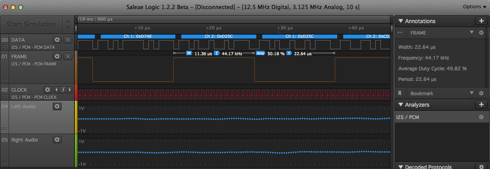

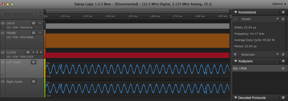

My problem is the i2s output has "clicks" in it which I can confirm by using a logic analyzer and an oscilloscope to observe the i2s bus coming from the K20 and the audio coming out from the codec.
You can clearly see the clicks in the audio waveform coming out of the codec (screen shot attached), but since that waveform is output from a codec connected to the i2s bus, it does not prove the problem is in my K20 code; it could be in the codec. To prove it was my K20 code that was the source of the problem, I used a logic analyzer to observe the i2s bus data itself (rather than the analog output), and then exported that data as a CSV file which I loaded into Google Sheets and graphed (screenshot attached). The same discontinuities are present in the graphed i2s bus data.
For good measure, I converted the CSV data into a .WAV audio file (audio file attached) and it sounds identical to the output from the codec, which is to say, has clicks in it. To be sure that the sin(x) method I'm using works, I wrote a small program to output nextsinevalue()to a .WAV file and it sounds as expected (i.e. no clicks).
I don't have any other interrupts or DMA channels going that I know of; I've looked through the MQX Lite code and don't see anything naughty happening behind the scenes.
The problem manifests regardless of it there is a debugger, JLink or logic analyzer connected to the board. After pouring through my code and comparing it to processor expert generated components, some semi-related sample code in the SDK and of course the various PDF application notes around i2s, I'm stuck. Any ideas from i2s and/or DMA experienced folk?
Screenshots, audio and code below. The interesting bits are in Task1_task(), configure_i2s() and configure_dma().The remaining code is mostly to configure the external codec over i2c.
