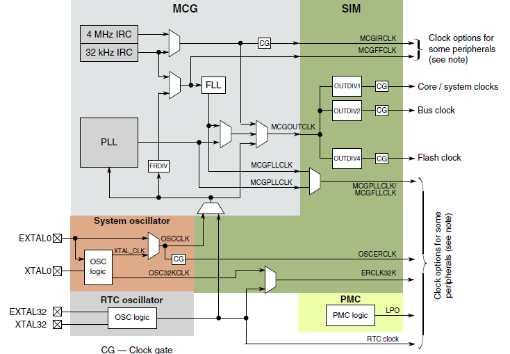

Hi all,
Has anybody tried to use Kinetis as USB Device employing the usb_clkin (PTE26) pin and provide usb clock externally? Is it possible to maintain device enumeration when kinetis is in low power mode if you provide 48MHz clock to usb externally?
My problem is that the lowest current consumption that enables usb enumeration is about 33mA. (>150mW, from 5V supply!!)
This is achieved WAIT mode, 48MHz.
Thanks!

Kari,
For USB you need two valid conditions, the first one is 48Mhz clock to make the oversampling on the USB lines to get an accurate 12Mbps code/decode and you must have a minimum frequency on the system clock to make sure that the data incoming from the USB its being stored correctly on the system RAM using the integrated DMA, this frequency is 20Mhz so if you are in Low power mode and you want to use USB the best option is to use the VBUS pin to wake up the MCU and enable the clocks before you enable the USB module.. also you can take the current that you need from the VBUS line instead of your batteries or whatever you are using meanwhile you are connected to a HOST.
So, you can have the 48Mhz on the USB_CLKIN pin but you also need 20Mhz on your system clock

Hi Kari,
The USB enumeration should work if you have the core clock on 20MHz. I think you are changing the entire PLL frequency and remember that you need 48MHz on the USB clock to be able to operate it correctly. On the SIM (system integration module) there are one register where you can change the PLL freq divider that goes to the core, BUS, flash and flexBUS so you can modify the BUS, flash and core to operate slower and leave the PLL at 48MHz to operate the USB
check this figure:
so just modif the SIM_CLKDIV1 register and you will be running slower but USB will work.
hope this help

Hi Jose,
It is now solved! Thanks very much for your help.
It was the RTOS clk setting procedure. The core clock needed to be set first to 24MHz (It is now from the FLL) and the USB clock 48MHz after that (PLL).
Kari

Now, I finally was able to find this information from the datasheet. It is said in 5.2.1 Device clock specifications.
System and core clock when Full Speed USB in operation. MIN 20 MHz.
