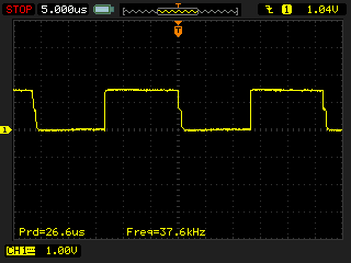

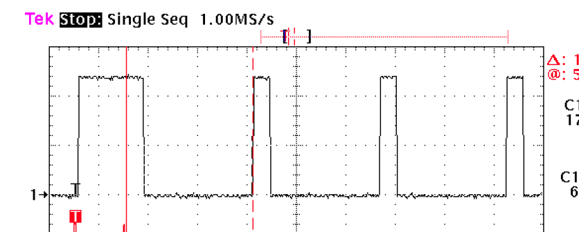

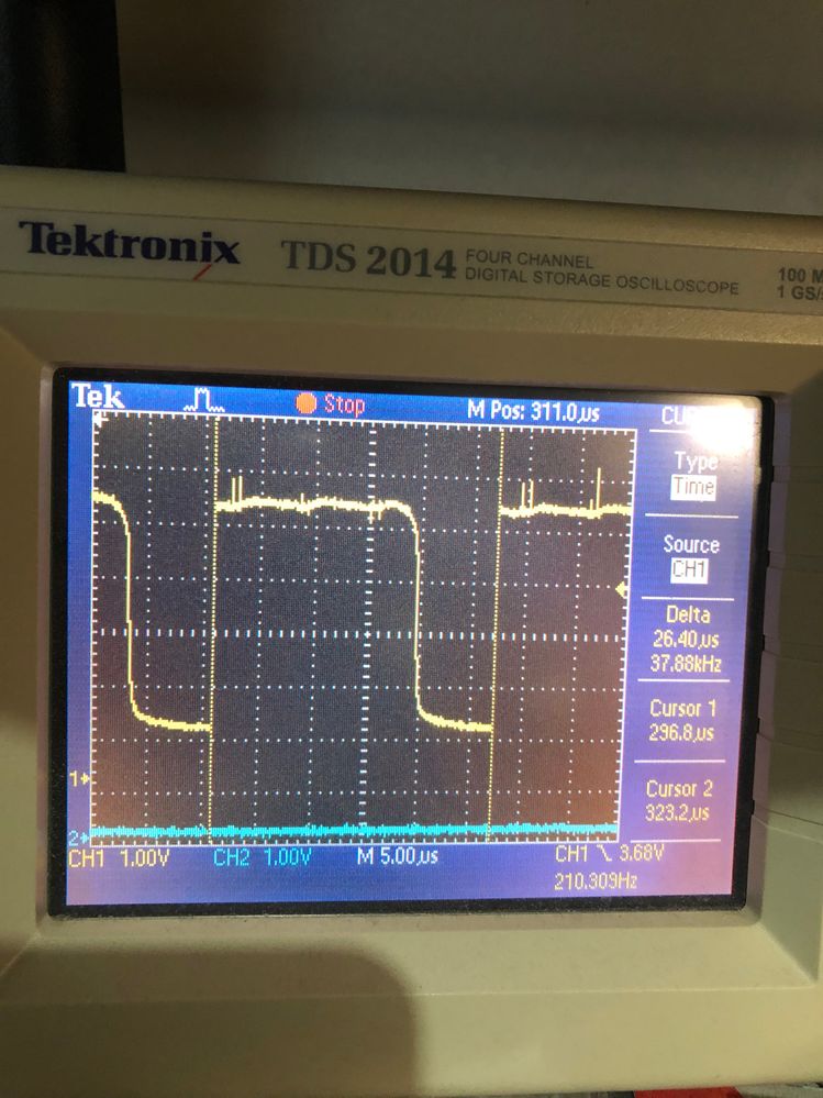

The PWM period is perfect but the duty cycle is above 77% (Period is 26.4us and the High part of the signal is 20.4us).
I'm taking the period value and dividing it by two - anybody see where my problem is?

Here's another data point:
I tried manually setting the compare value (FTM0_C7V) and discovered that the change in terms of the PWM isn't linear.  The timing values (measured on an oscilloscope) I got are:
FTM0_C7VPeriod (us)PWM High (us)PWM Low (us)C7V / PWM High
63126.420.46.00.032330
30026.413.612.80.045333
27526.413.213.20.048000
25026.412.4140.049600
It looks like the PWM counter/Compare module (FTM0_C7V & "output modes logic") is getting a different clock from the "FTM counter" and the "FTM0_MOD" register.  This doesn't make any sense when I look at the FTM block diagram (Figure 38-1) in the K20P100M100SF2V2RM (Reference Manual) documentation - I'm looking at Rev. 2 Jun 2012 which is the current at NXP.com.
Any ideas what's going on here?  In the short term, I know what gives me a 50% duty cycle (FTM0_C7V = 275) but this doesn't make sense according to the documentation, other posts and example code.

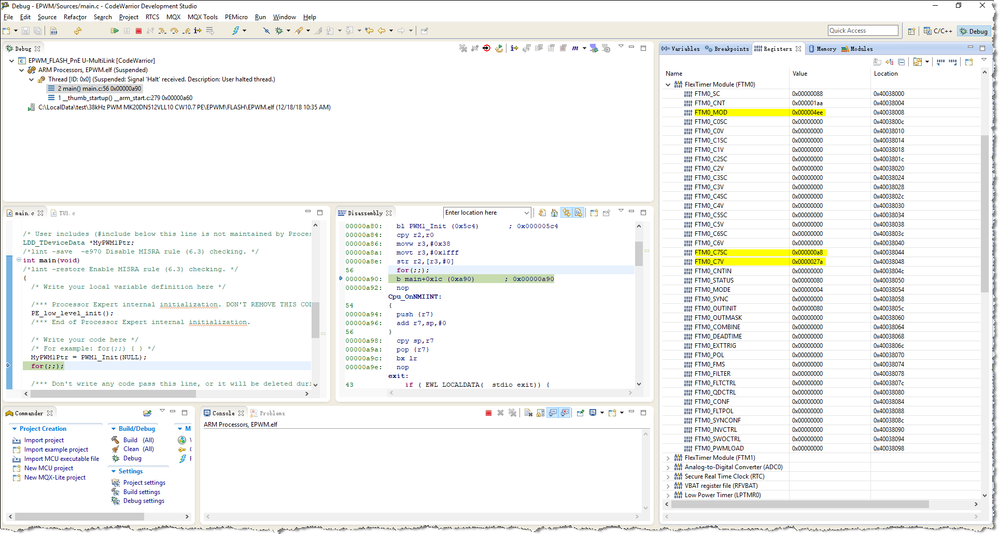

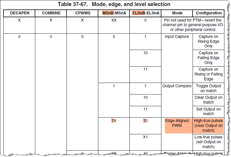

Hi myke,
Have you try to observe the register value during debug in CodeWarrior11?
For example:FTM0_C7V and FTM0_MOD and FTM0_C7SC
Seems you have select EPWM:
Robin

Hi Robin,
Thank you for the reply.  Yes, I am verifying the register values using CW.
I did use that table from the Reference Manual for setting up the PWM and the bits you highlighted have been set with the three lines:
  FTM0_C7SC |= FTM_CnSC_MSB_MASK;  //  Set FTM0 Channel 7 Operation
  FTM0_C7SC |= FTM_CnSC_ELSB_MASK;
  FTM0_C7SC &= ~FTM_CnSC_ELSA_MASK;
When I check the FTM0_C7SC register in CW, I see the MS7B = 1, ELS7B = 1 & ELS7A = 0.

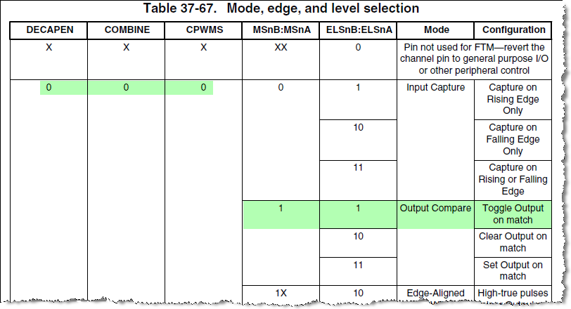

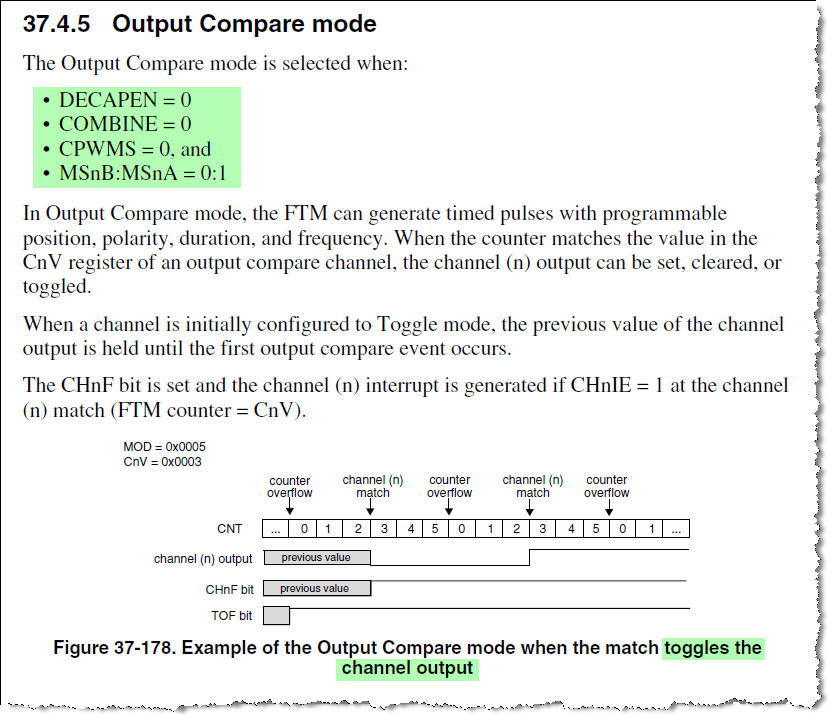

The easiest way to get a 50% duty cycle is to choose Output Compare mode and configure it Toggle Output on match.
Please try to use this mode first.
You'd better to give me the register value screen capture, so that I can check if the register of FTM is correct or not.

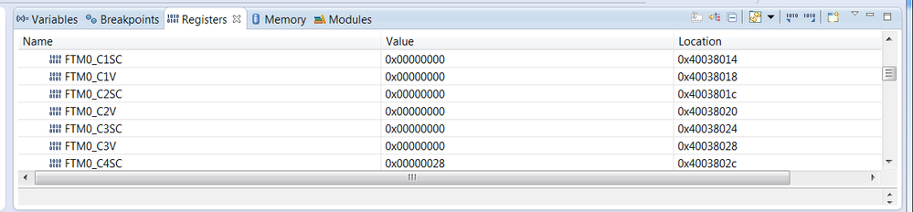

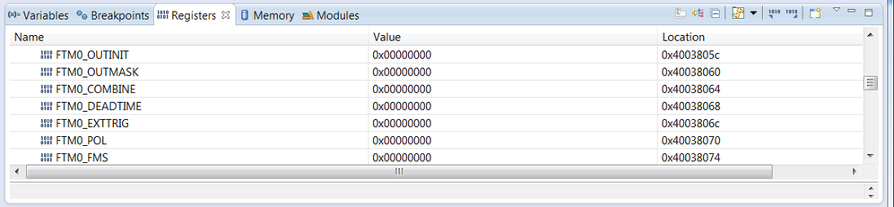

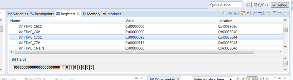

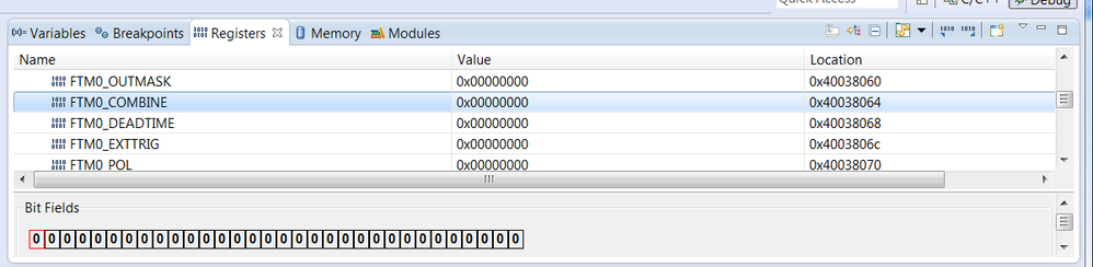

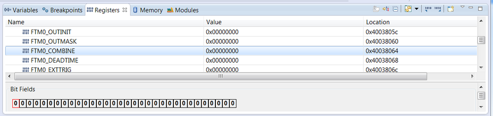

As requested, here are the register values, taken as screen shots from CW 11:
Let's start with FTM0_COMBINE (which includes DECAPEN# & COMBINE):
- DECAPEN# - All Bits Reset
- COMBINE# - All Bits Reset
Now, the documentation says that this is for "n = 6" - do I want for "n = 7" as I'm using FTM0_C7?

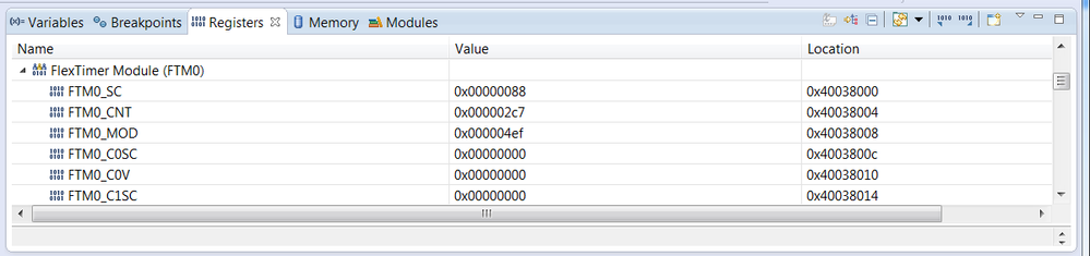

For FTMO_SC:
- Bit 5 CPWMS (Center-Aligned PWM Select) - Reset which is what we want

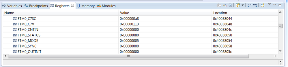

Next is FTMO_C7SC:
Using the datasheet:
Bit 5 - MSB (Channel Mode Select) - Set which is what we want
Bit 4 - MSA (Channel Mode Select) - Reset as it is a don't care for this application of the FTM
Bit 3 - ELSB (Edge or Level Select) - Set which is what we want
Bit 2 - ELSA (Edge or Level Select) - Reset which what we want for this application (ELSB:ELSA = 1:0 is "Clear Output on Match)
Any comments?  Other than the DECAPEN/COMBINE confusion regarding using them for FTMO_C7, I think I'm good.

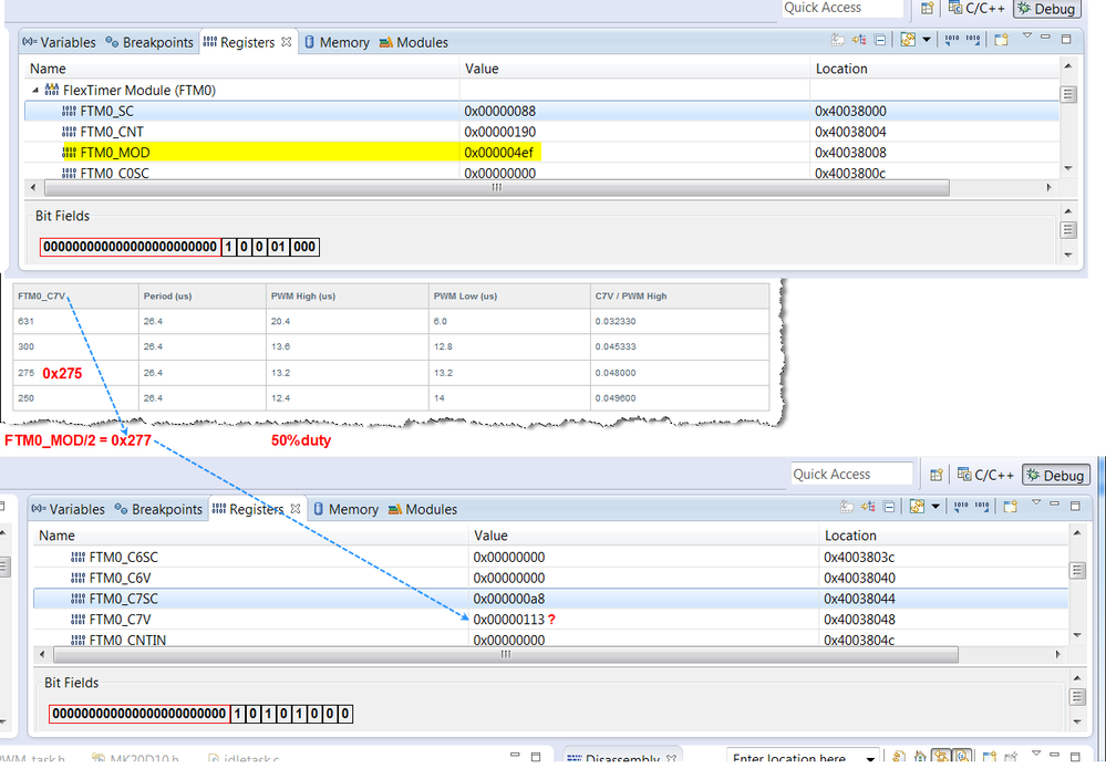

Robin_Shen
If you want to get 50% duty PWM when FTM0_MOD=0x4ef, you should configure FTM0_C7V=0x277
Robin
7,854 Views

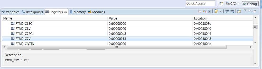

myke_predko
Senior Contributor III
Hi Robin,
Totally agree with what you're saying but...

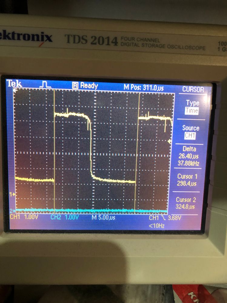

When I run with the original values with the register set up and manually writing in 0x113:
I get the waveform:
Now, when I put in the expected 50% duty cycle value (0x277 as you noted) with the registers:
I get the waveform:
I'm sure there's something that I'm doing wrong, but for the life of me, I can't figure out what it is.
Any ideas?
myke

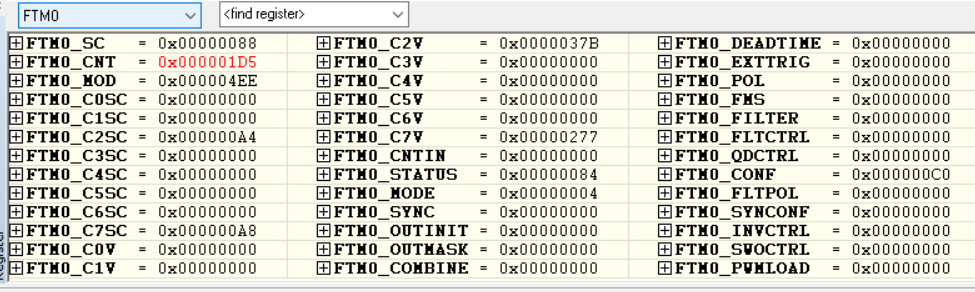

mjbcswitzerland
Specialist V
Hi Myke
I just set up a uTasker project on a K20, running at 96MHz (as yours, with 48MHz bus clock):
    PWM_INTERRUPT_SETUP pwm_setup;
    pwm_setup.int_type = PWM_INTERRUPT;
    pwm_setup.int_handler = 0;
    pwm_setup.pwm_mode = (PWM_SYS_CLK | PWM_PRESCALER_1 | PWM_EDGE_ALIGNED); // clock PWM timer from the system clock with /1 pre-scaler
    pwm_setup.int_handler = 0;                                          // no user interrupt call-back on PWM cycle
    pwm_setup.pwm_reference = (_TIMER_0 | 7);                           // timer module 0, channel 7
    pwm_setup.pwm_frequency = PWM_FREQUENCY(38000, 1);                  // generate 1000Hz on PWM output
    pwm_setup.pwm_value   = _PWM_PERCENT(50, pwm_setup.pwm_frequency);  // 50% PWM (high/low)
    fnConfigureInterrupt((void *)&pwm_setup);                           // enter configuration for PWM test on PTD7
I measured then 38kHz on PTD7 and 50% mark-space.
These are all the FTM0 registers
(I also had an output on channel 2 but ignore that).
I notice you have a very slow falling edge on your output but it my be due to loading you have.
I don't know whether it helps in any way but the setting above give the expected output.
Mark

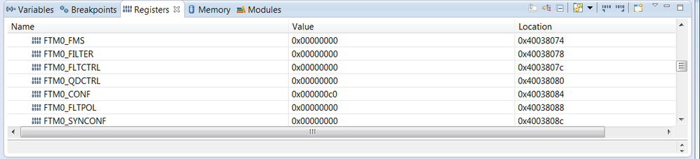

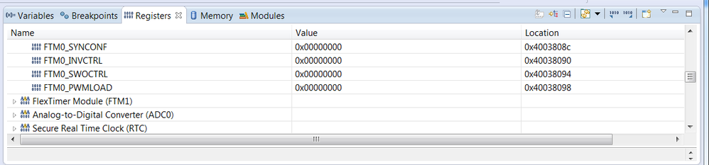

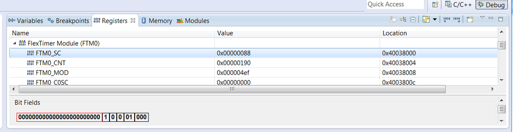

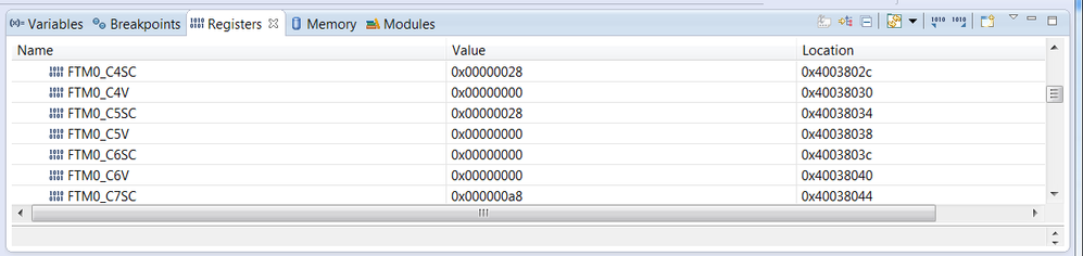

Here are my registers:
2018.11.29 - FTM0 Register Values 4.png2018.11.29 - FTM0 Register Values 5.png2018.11.29 - FTM0 Register Values 6.png2018.11.29 - FTM0 Register Values 7.png
The differences between your values and mine are listed in the table below:
RegisterMark ValueMyke ValueComments
FTM0_MOD0x4EE0x4EFFTM Count Register/No issue
FTM0_C2SC0xA8FTM0_C4SC/FTM0_C5SC: 0x28Comparing to my _C4SC & _C5SC which have not run yet
FTM0_STATUS0xA40xA0Mark's value indicates that Channel 2 has overflowed
FTM0_MODE45Myke has FTM Enable Active
So, unless the FTM Enable bit affects things, I think I have exactly the same operating environment as you do - comments?

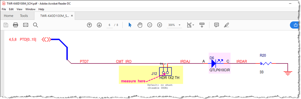

Finally, I'm scoping at the anode of an IR LED which is driven by a variable current supply, so the rounded edges when the signal goes low isn't that much of a surprise.
Thanx for the comparison point - maybe something will come of it!

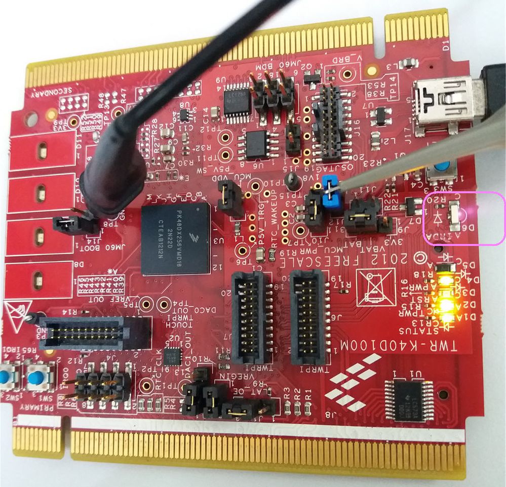

Robin_Shen
Please check the attached project.
See also the registers value and the waveform of IR on TWR-K40D100M.
Robin
