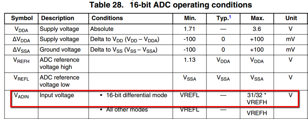

I am using the ADC on a K20F120, and getting results that are exactly half what they should be (according to an oscilloscope which I am measuring the input with).  My configuration is as follows:
core clock = 120 MHz
bus clock = 60 MHz
ADC clock = 7.5 MHz
ADC mode = 16 bit differential
ADC trigger = software triggered, free running
ADC triggers DMA transfers on conversion complete
ADC is calibrated before being used
ADC is running at correct speed
No PGA configured
ADC range is 0V-3V (approximately the same as Vdd)
I can post the configuration if that would help (I am not using processor expert), but I am wondering if anyone has encountered this issue before.  It looks as if the results are being right-shifted.  The problem could be something with the ADC or DMA.
Any input would be greatly appreciated. Thanks for reading my post!

Those are actually the expected ADC result. Please be aware that the ADC result is a 16-bit register, therefore the sign will be on D15. For your configuration the ADC result will be around
-32768 when DP = 0 V and DM = 3 V
32767 when DP = 3 V and DM = 0 V
To calculate the LSB you need to use 15-bit resolution because the most significant bit is used like a sign
Using 91.55 uV with 1.5V differential input the ADC result will be ~16384

For the Kinetis 16-bit SAR differential reads means that you have a pair of external pins.
The ADC digital result is the subtraction between the differential inputs
ADCRn = DPx -  DMx
     DPx -- Differential input plus
     DMx -- Differential input minus
This doesn't means that the ADC accepts negative input voltages, the ADC input voltage range is between VREFL and 31/32 VREFH
The ADC output format is in 2's complement 16-bit signed will be

I guess we need to be more explicit.  The setting of 'differential mode' means that IN+ can be 3V, IN- 0V, and the reading will (ideally) be 0x7FFF (positive max).  Conversely, IN+ can be 0V, and IN- at 3V (for a 'net' -3V signal) and the 'ideal' reading will be 0x8000 (max negative).  This is all 'not counting' the errata that limits positive voltages to 31/32 of VrefH (2.9V on a 3V reference like REF3030) or full-scale 0x8400 thru 0x7BFF.

So if the 'other input' is 1.5V, then the 'differential voltage' measured relative to the 'primary' input is thus at most 1.5V above, or 1.5V below, or half of full scale of +/-3V (a full 16-bit span of 6V), exactly as you report.  To get a 'full scale' differential signal will require one of the inputs at ground, the other at 2.9V.  If you are 'simply biasing' the '-' input at 1.5V, and are NOT 'routing' it along with the '+' input to the ultimate source, in a manner to reject some AC/DC interference, then I strongly suggest you just sample the '+' input in single-ended mode (and invert the MSB to turn it into a sign-bit, so that 'half scale' 0x8000 becomes 0x0000).  I am a little confused by your use of the term Vref -- to the ADC, VrefH is the 'source of scaling reference' against which the analog input voltage (single-ended, or the difference of two inputs in differential mode) is defined.

The 'whole range', considered differentially, is 6V, from -3V to +3V.

"ADC mode = 16 bit differential" means the ADC range is -3V to +3V.
