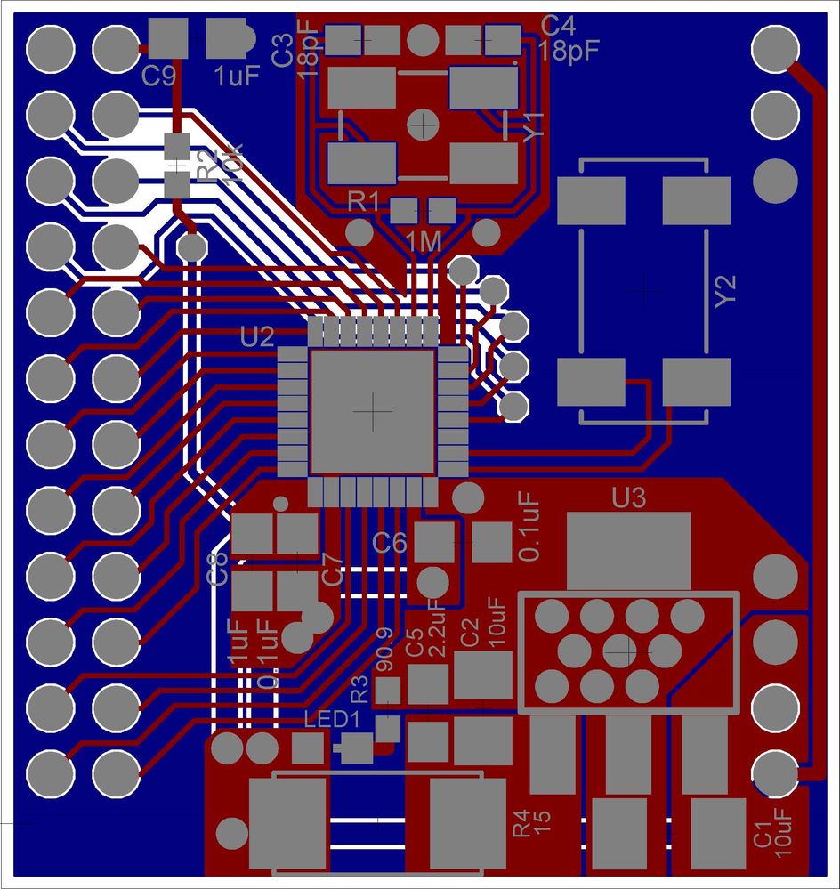

kerbal
New layout:
  • There is nothing tricky happening on the bottom side. The traces go where they appear to.
  • The 4-pin connector from top to bottom is GND, VIN, 5V, 3.3V
  • Forgot to turn off TORIGIN
  • I elongated the pads for the uC beyond the edge of the package to facilitate hand soldering
  • VBAT is currently unconnected
  • RTC crystal traces will be rebalanced

kerbal
Thanks for your reply! My little board finally fired up late last night.
You can skip all of the debugging stuff above, but the underlined parts are all of my questions and I'd still prefer to have a definitive answer on them.
I have the standard Multilink-U, so 1Mhz is my max speed.
Each time reset went low due the WD reset, it would bottom out at around 1V instead of GND. The signal would correct itself when I pressed firmly downward on the K10, and revert when I released. I hit it with the heat gun as a last ditch effort and the reset signal became consistently correct. After some more poking around (almost) aimlessly, I noticed that EZP_CS was staying low. In all previous attempts, it was always held high somehow without a pull-up. Does EZP_CS change states after a successful JTAG>SWD sequence? If so, the SWDIO/SWDCLK/XX lines were probably disconnected. If not, EZP_CS was probably shorted. Too late to know for sure now.
So, now, everything works. It flashes fine, mass-erases fine, debugs fine. Some time soon, I will try USBDM/OpenSDA/etc. again but don't expect any problems.
With all that said, I'm going to order the revised layout later/tonight. Before then, can you suggest any additions to the layout above?
This is my initial experience with custom boards (noob). Some or none of the following may apply:
  • I could add the bypass caps on the SWDCLK, etc. but should I? It's no longer broke, so do I fix it some more?
  • I would somewhat like to remove R4 and C1; they were added in this troubleshooting process and enlarged the original board. The board that works has neither of them. R4 was intended to limit the slew rate of VDD/VBAT per errata mask. I added C1 because it seemed "good to"; bulk input cap seems like it could go on each power module instead of the mainboard. Opinion?
  • The FRDM-KL25Z has two inductors on each of the USB's coming in. Are their resistance values purely filter related, or were they selected to act like my R4?
  • After programming, the final boards will be in an enclosure, possibly potted, etc. Basically, it is only intended to be re-configurable for me. Once it is sold as a finished device, the end user will have no access to it for making connections, modifications, or otherwise screwing it up. When they fail, the whole unit will be replaced. It's a bonus if I can correct failed devices and send them back out, but not a requirement.
  • Some of the boards will be running radios. (noise? additional filter values?)
  • Some will be running from a 12V transformer on the AC mains. (full-bridge>10uF bulk caps>regulator>filter caps>power planes with filter caps (more noise?))
  • The design is stackable; since everything will be snugly and closely connected at the pin headers, can I apply bypass caps and other remedies to the elevated addon modules instead of the mainboard? How much 'bad' does using pin header connections add? I see the FRDM-KL25Z has no filters on anything leading to the pin headers.
  • The electrical distance from top board center to mainboard center is just a little over 1.0 inches.
  • The electrical distance from top board power side, across top board, through pinheader, down to mainboard center is just a little over 1.5 inches. Each additional layer adds ~0.2 inches.
  • I'm open to adding [probably] important design considerations to the mainboard and leaving them DNP if ultimately unneeded. I'd rather do that than wait another turnaround period for version 3 to arrive.
Thanks again!

kerbal
e2548 -
1. Use a very low impedance connection between the power supply and the MCU Vdd pins.
This helps with the Vdd spike when the MCU goes from a full load to a no-load condition.
2. Avoid any supply ramp rate greater than 2.0V/100mS after the first power-on supply ramp.
For example, do not power up the MCU at 2 V and then ramp Vdd to 3 V later. If you want to
ramp to 3 V, do that in a single ramp.
3. Provide a clean power supply to the MCU. Ripples on Vdd can cause PORs.
My first layout routed the regulator output to:
  • 10uF bulk cap
  • Trace from bulk cap to decoupling cap located next to VDDA
  • Traces from VDDA cap to VDD and VBAT
Would that, alone, explain all of the problems I'm having?
My new layout resembles a scaled-down FRDM-KL25Z:
1) On the FRDM, 10.0uF caps are used before and after the external regulator:
  • My new layout includes one 10uF on the regulator's input (5-12V)
  • My new layout includes one 10uF on the regulator's output (3.3V)
  • Why 10uF? These are bulk storage caps and just need to be "big"; correct?
2) On the FRDM, 2.2uF caps are used at all VOUT33 pins:
  • The value should be a function of the frequency of processor demand and the amount of ripple coming from the regulator.
  • Why 2.2uF? (with 3.3V?) Was this precise value calulated through testing or simply a "good value" when using 3.3V regulators?
  • Using a 3.3V LDO, my new layout includes one 2.2uF on the regulator's output
3) On the FRDM, decoupling caps:
  • C5, C6, and C14 are 1.0uF
  • C10, C11, and C13 are 0.1uF
  • They are grouped in two's around the VDDx pins
  • Per the actual, physical, board I have:
    1. One VDD pin has two 1.0uF (C5, C6)
    2. One VDD pin has one 1.0uF and one 0.1uF (C13, C14)
    3. One VDD pin has two 0.1uF (C10, C11)
    • It "seems like" one of each cap should be at each set of pins, but the lacing on the board indicates otherwise.
    • Why? Are there specific reasons to provide different specific values at specific VDD pins?
  • My new layout includes one 1.0uF and one 0.1uF at VDD/VSS
  • My new layout includes one 0.1uF at VDDA/VSSA
4) To limit the slew-rate per errata:
  • The regulator output is connected to one 10uF cap, one 2.2uF cap, and one 15ohm (1W) resistor
  • The other side of the caps connects to ground directly adjacent to the regulator GND
  • The second resistor pin connects to a copper pour that distributes power to the rest of the board
  • The 3.3V pins that supply/receive power to/from external modules (pin header) connects to the pour
  • The VDD power plane and capacitors connect to the pour via a >20mil trace
  • The VDDA power plane and capacitor connects to the pour via a >20mil trace
  • 10k pull-up for !RESET connects via trace to the VDD power plane
5) Thermal pad:
  • True or false?: Soldering it is recommended, but not required
  • It is my intent to reflow only the edge pins and begin testing
  • To help reduce the chance of destroying any more chips, I reduced the number, and increased the diameter of the thermal vias under the chip. If anything useful happens on the chip, I may consider hand-soldering the thermal pad through the way-oversized vias. I made them large enough, that I should be able to do the fill very fast, by hand, and without even using my microscope.
6) VBAT:
  • I haven't figured out if, and how, I'll route VBAT; is it not in a convenient location with my layout
  • I'm considering running the outside edge of the trace along the current outside edge of the exposed copper, but I suspect that's not actually a good idea
  • Can I encroach on(under) the thermal pad when routing 3.3V to VBAT?
  • The errata pertaining to VBAT slew-rate suggests adding an inline resistor to the pin, indicating that a long route for VBAT would be acceptable and even potentially helpful.
  • With the slew-rate already corrected, would a long trace for VBAT still be acceptable?
7) The reset switch is mounted on a different PCB than the CPU:
  • The 10k pull-up for reset was on the CPU PCB and will remain there
  • The 1uF cap on reset was located on the PCB with the switch
  • The 1uF cap on reset is now located on the CPU PCB near the external pin connection
  • An uninitialized chip supposedly outputs a square wave on the reset pin...
  • My reset pins all went partially high, but then immediately began a parabolic discharge. There was no width to the drive and, although I didn't measure it specifically, I don't think the reset pins ever reached a full 3.3V before beginning to drain
  • The pattern repeats at the correct interval, despite its' shape
5,412 Views

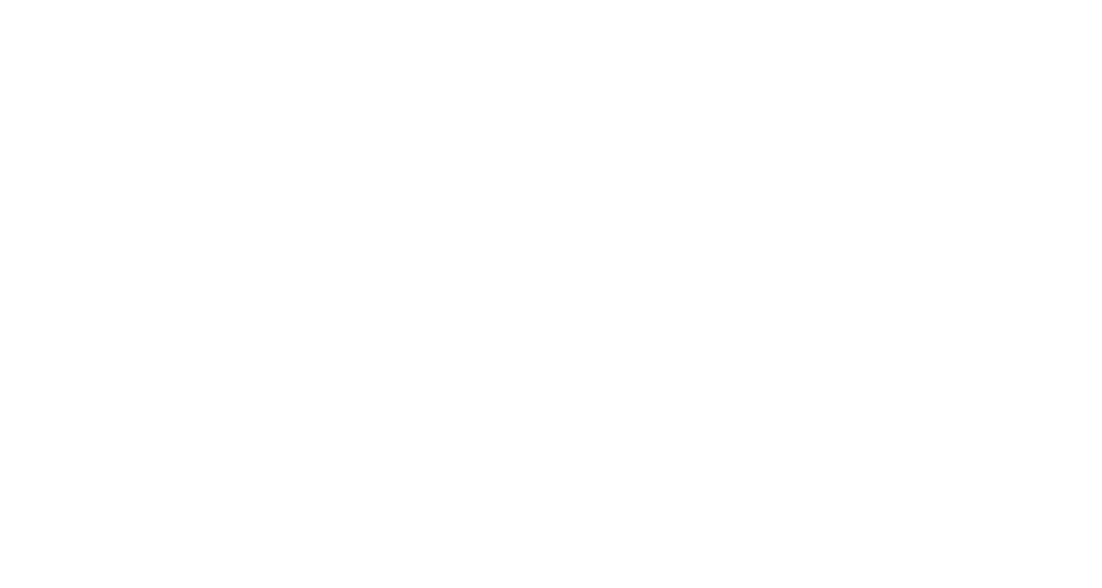

kerbal
Below is a scope of SWDIO (red) and SWDCLK(yellow).
  • The first rising clock edge after the first falling data edge is the SWD stop bit
  • The line is driven high and then "parked"
  • The first clock of the group of 4, should be the turnaround clock
  • For the next 3 clocks, my chip should ACK with b100 (little-indian)
At the rising edge for each bit of ACK, there is a small drop in the data line...
Possibly:
1) My chip is trying to pull the line low but can't or doesn't:
  • Assume there are no electrical shorts
  • Assume there is insufficient filtering and other neglected design issues and/or errata
  • If the chip IS responsible for the drop, then it is alive and was not destroyed during soldering
  • If the chip IS alive, it seems to be aware of WHEN it should respond, indicating that the internal oscillator is probably running correctly
  • What would cause a correctly soldered and otherwise-working chip to exhibit this behavior?
2) My chip is doing nothing:
  • I fried every one of them while soldering
  • The drop is the result of the debugger sampling the line
  • Is this possible/reasonable and likely?
There is no feedback from anything besides the "it didn't work" dialog.
