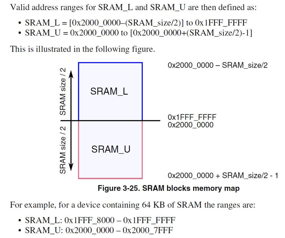

Hui_Ma
MK10DX256ZVLQ10 SRAM size is 64KB, please refer below picture about SRAM memory map, which should be from from 0x1FFF8000 to 20007FFF.
SRAM_L & SRAM_U split address is fixed to 0x20000000.
Wish it helps.

LPs
Hi guys,
I have a complete knowledge about the memory organization and the memory map of this PCU MK10DX256ZVLQ10.
What I mean is that it's more than one year that I'm using this PCU and I have produced thousand of devices where the firmware works mapping on 128k from 0x1FFF_0000 to 0x2000_0000 as SRAM-L and from 0x2000_FFFF as SRAM-U and it works always correctly.
Moreover, with the debugger I'm able to see all the 128k mapped SRAM. The font of the application are mapped from 0x1FFF_1000 (that are, in theory, out from the 64k available).
So my question is...is it possible that this PCU is always equipped with 128k SRAM because of freescale does not want to produce two different silicons, providing guarantee just on the declared 64 SRAM (as in other case INTEL did with Pentium II cache)?

I recommend doing the following test:
Using a debugger, write a value to the address 0x1fff0000 - if it reads back the same value there is SRAM there
Check the address 0x1fff8000 - if the value follows the value that you wrote to 0x1fff0000 it is being mirrored and there is 64k (but being written/read at different locations)
You can repeat at 0x20007ff0 and 0x2000fff0 (for example).
Normally there will be an access error generated when reading/writing outside fo the SRAM area but maybe there is a difference in your device
If you can write/read without mirroring effect you really have 128k SRAM.
If mirroring is taking place the code will probably still be able to run as long as it doesn't use more that 64k (since its static variables are probably starting at 0x1fff0000 and its stack using the 0x2000ffff area (which mirror to 0x1fff8000 and 0x20007fff respecively and so don't corrupt each other).
