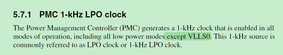

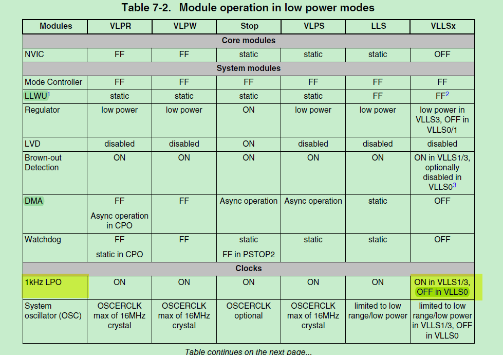

Hi Isaac Romero,

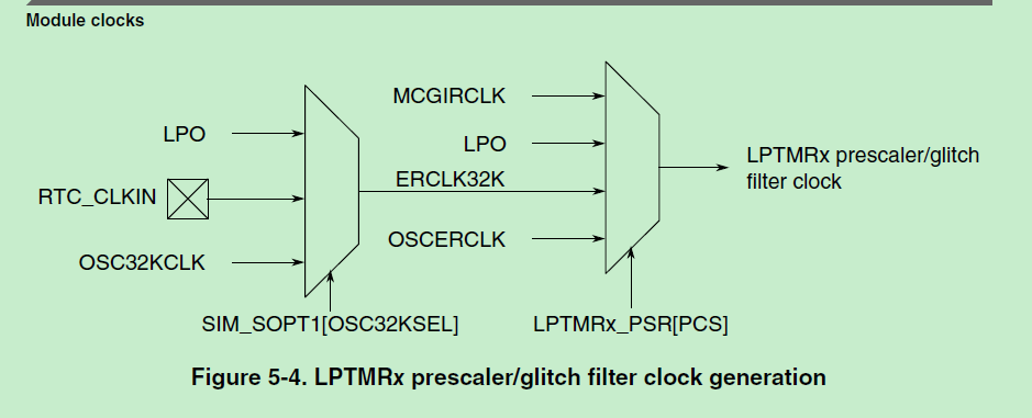

    What the VLLS mode you are using? If you are using VLLS1/3, you can use the LPTMR with 1khz LPO as the wake up source to make the VLLS1/3 more than 1minute.
    You can choose LPO as LPTMR clock source.

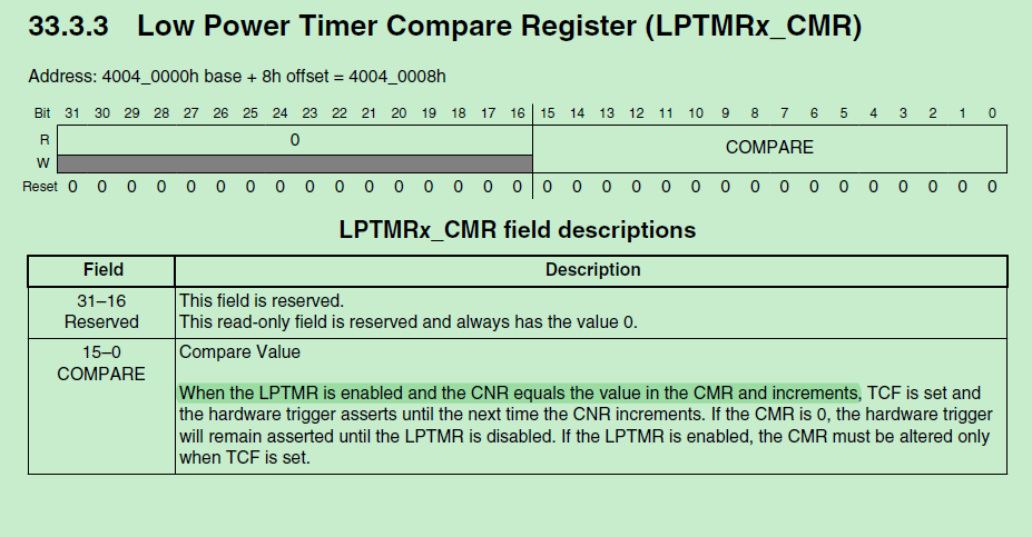

Then, from the LPTMR register:
CMR is 16 bit, it is 65536, so you can reach:65536*1ms=65.536s intervals.
so you can reach 60s =1minute.
Wish it helps you!
Kerry

isaacromero
Hello my friend, kerryzhou
I will try to reach it with the CMR but it will be a cycle from VLLS1-Run-VLLS1. I was trying to avoiding it(many cycles to stay more time in stop mode).
VLLS1 resets the systems after WakeUp, but what I want is to stay about 20 minutes sleep and return to RunMode without resets, what I fond was using LLS1.
Thanks!
