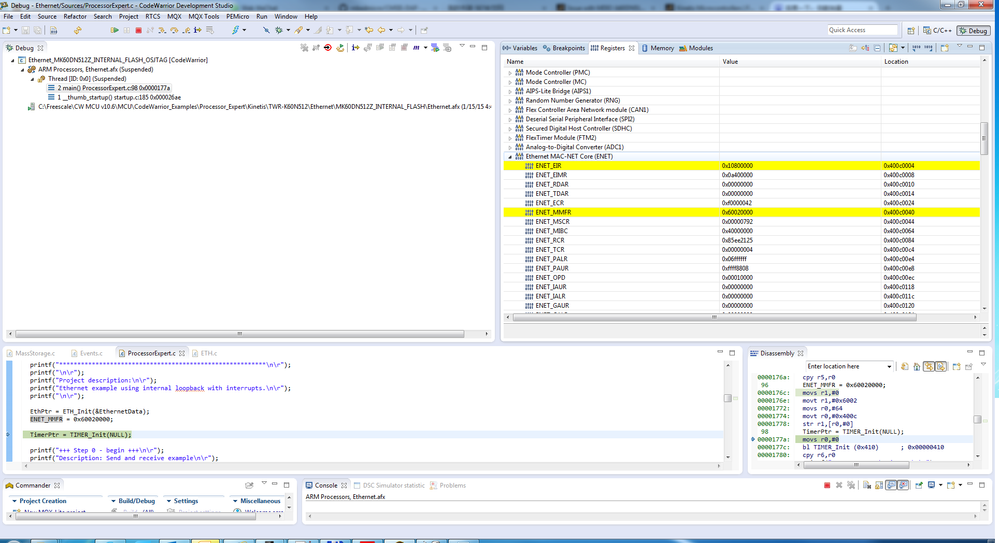

Hello Everyone,
I am using K60DN512 device with Lan8720A phy device.
I have initialized the Ethernet MAC, but there is no data on MDIO pin (I have checked on logic analyser)
I have done following initialization.
GPIO
SIM ->SCGC5 |= SIM_SCGC5_PORTA_MASK | SIM_SCGC5_PORTB_MASK;
    //Configure RMII0_RXER (PTA5)
    PORTA ->PCR[5] = PORT_PCR_MUX(4) | PORT_PCR_PE_MASK;
    //Configure RMII0_RXD1 (PTA12)
    PORTA ->PCR[12] = PORT_PCR_MUX(4);
    //Configure RMII0_RXD0 (PTA13)
    PORTA ->PCR[13] = PORT_PCR_MUX(4);
    //Configure RMII0_CRS_DV (PTA14)
    PORTA ->PCR[14] = PORT_PCR_MUX(4);
    //Configure RMII0_TXEN (PTA15)
    PORTA ->PCR[15] = PORT_PCR_MUX(4);
    //Configure RMII0_TXD0 (PTA16)
    PORTA ->PCR[16] = PORT_PCR_MUX(4);
    //Configure RMII0_TXD1 (PTA17)
    PORTA ->PCR[17] = PORT_PCR_MUX(4);
    //Configure RMII0_MDIO (PTB0)
    PORTB ->PCR[0] = PORT_PCR_MUX(4) | PORT_PCR_PE_MASK | PORT_PCR_PS_MASK;
    //Configure RMII0_MDC (PTB1)
    PORTB ->PCR[1] = PORT_PCR_MUX(4);
GPIO is configured as alternate function 4, as mentioned in datasheet.
Next disabled the IRQ
//Disable Ethernet MAC interrupts
    NVIC_DisableIRQ(ENET_Transmit_IRQn);
    NVIC_DisableIRQ(ENET_Receive_IRQn);
    NVIC_DisableIRQ(ENET_Error_IRQn);
Next initialized the MAC
//Enable ENET peripheral clock
    SIM ->SCGC2 |= SIM_SCGC2_ENET_MASK;
    //GPIO configuration
    mk60EthInitGpio(interface);
    //Reset ENET module
    ENET ->ECR = ENET_ECR_RESET_MASK;
    //Wait for the reset to complete
    while (ENET ->ECR & ENET_ECR_RESET_MASK)
    //Reveive control register
    ENET ->RCR = ENET_RCR_MAX_FL(1518) | ENET_RCR_RMII_MODE_MASK
            | ENET_RCR_MII_MODE_MASK;
    //Transmit control register
    ENET ->TCR = 0;
    //Configure MDC clock frequency
    ENET ->MSCR = ENET_MSCR_MII_SPEED(19);
Next read the first SFR of the Phy device.
uint32_t value = ENET_MMFR_ST(1) | ENET_MMFR_OP(2) | ENET_MMFR_TA(2);
    //PHY address
    value |= ENET_MMFR_PA(phyAddr);
    //Register address
    value |= ENET_MMFR_RA(regAddr);
    //Clear MII interrupt flag
    ENET ->EIR = ENET_EIR_MII_MASK;
    //Start a read operation
    Bit1_SetVal(NULL);
    ENET ->MMFR = value;
In the last line, the value comes out to be 0x60020000 (TA = 10 ... This field must be programmed to 10 to generate a valid MII management frame.), when it executes the value of MMFR  is 0x60030000 (TA=11). Why is this happening.
I think all the values are initialized correctly. When I checked on logic analyser, there is no output. However as soon as I execute the command, the MII interrupt flag of EIR is set.
I tried changing the value of TA to 10 (In debug mode, through the register view), but it simply doesn't work.
Is there something wrong with the initialization. I have not connected the CAT cable, but I feel that shouldn't make any difference.

Hi ,
Just some more suggestion, Since you are using RMII mode for your application, then 50MHz should be feed to the Enet module, so the internal MAC clock frequency is 50MHz as well, and according to RM, The MII_SPEED field in ENET_MSCR must be programmed with a value to provide an MDC frequency of less than or equal to 2.5 MHz to be compliant with the IEEE 802.3 MII specification. RM recommends 0x9 for the case of 50MHz, here you used 19 so will have a 1.25MHz MDC clock, not sure if that is the root cause, but you may try to adjust the value as below to see if it makes any difference.
ENET_MSCR = ENET_MSCR_HOLDTIME(0x07) |
              ENET_MSCR_DIS_PRE_MASK |
              ENET_MSCR_MII_SPEED(0x09);
Hope that helps,
Kan

Did you find a solution to this issue?  I am having a similar issue.  The TA bits of the MMFR register are always set to 3 even though I set them to 2 in software as well as in the debugger.
We are using a Kinetis K61, a 83848 phy device and I am using MQX on my project but the problem is the same.  I did see that ENET_MSCR_MII_SPEED in my design was being set to 18 and I changed it to 9 but this did not fix anything.  Any information that you could offer would be a help.
Dan
2,711 次查看
lh_dan
Found my issue.  The 83848 phy device defaults to an address of 1 and MQX defaults to 0.  Don't know why this affects setting of the TA bits, but after changing BSP_ENET0_PHY_ADDR to the correct address all is well.
-Dan

I am sorry, but I can not reproduce your issue on TWR-K60N512, you may find the MMFR is 0x60020000 after the write operation, and I provided a code snippet for Enet initialization for your reference, please kindly refe to it for details.

you may refer to the example in "C:\Freescale\CW MCU v10.6\MCU\CodeWarrior_Examples\Processor_Expert\Kinetis\TWR-K60N512\Ethernet" for more details.
Hope that helps,
Kan
2,711 次查看
trilokjt
Hi Kan
I have same issue I'm using RMII mode and external clock is 50Mhz, but on MDC signal getting around 4.55Mhz. Please can you tell me exact problem.
thank you
Trilok
