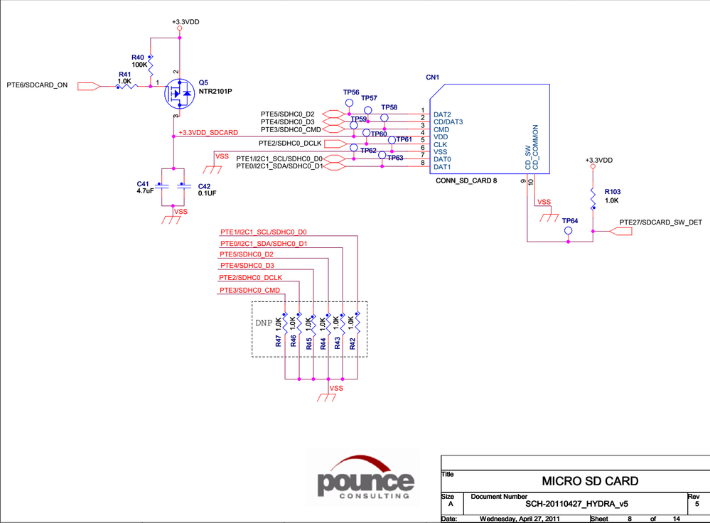

I have made a code for SD card for KwikStik. Using FatFS and SDHC components of processor expert But it is not working. I have successfully tested similar code for SD card using SPI protocol with K20 uc it is working fine. I Just wanted any demo code for SD card to test if all the syntax I have written is correct. I am attaching my code. Kindly have a look and resolve the issue.

I had a look at the schematic  and I enabled the PTE6 by clearing the value, 3.3V is coming on TP59 (Vcc for SD card) but still the issue is not resolved. I am still unable to create any file in SD card. I probed TP60(SDHC0_DCLK) to CRO, there was no pulse.

If you would like to check your hardware you can download an SD card boot loader for the KWIKSTIK V5 here:
http://www.utasker.com/SW_Demos.html#K40
This will display the state on the SD card on your board on its LCD display so that you can detect whether it is not seeing it, it is not formatted, etc. The display images are detailed on page 23 of http://www.utasker.com/docs/uTasker/uTaskerSerialLoader.PDF
The SW can be loaded to the board using CW's flash utility. If the SD card is being detected you can put the file "software_1.4.003" onto it in the root directory and rename it to "software.bin" and then it will be loaded to the K40 and executed (this displays a clock in the LCD). If this works it will verify that the problem is not due to a local HW issue.

Please check which revision Kwikstik you have since revisions 3 and 4 have the SDHC incorrectly connected. I think that you need revision 5 for it to be correct.
http://cache.freescale.com/files/32bit/doc/errata/KWIKSTIKK40HWER.pdf?fpsp=1&WT_TYPE=Errata&WT_VENDO...
If you have an older one you can still use SPI mode.

Thanks for replying I have checked the hardware It is version 5 and also went through the errata for rev 5 over there they have mentioned that SDHC has been corrected. But I don't know if there is still the issue.
