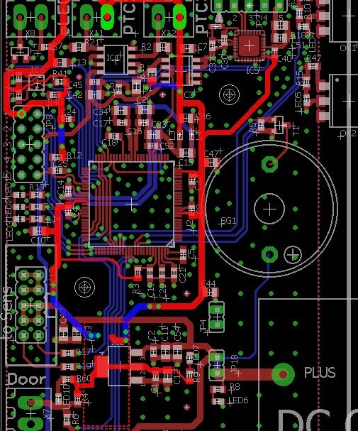

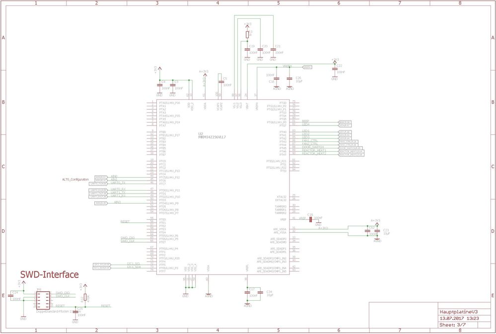

I have got a problem in the 3rd revision of scematic/layot which I do not understand.
When I take the new unprogrammed PCB's and power up (POR) - then I can't program it.
So I looked at the RESET-Pin - and this got a voltage of 390mV.
The RESET Pin is normally Pulled up with a 470R Resistor.
If I connect the RESET Pin direct to 3.3V - a current of approx 30mA is measurable - so it looks llike the Reset drives as an Output.
I tried with different PCBs - same behaviour.
So does anybody has a idea what could be?
Best Regards
Manfred
Some measurements later...
The RESET Pin of the uC is driven low by the Kinetis itself for some microseconds - then released - then driven low again - and so on...
It looks like a Pulse Width Modulation with a frequenc of approx 3 kHz.
What could be a reason for this behavior?
Best Regards Manfred

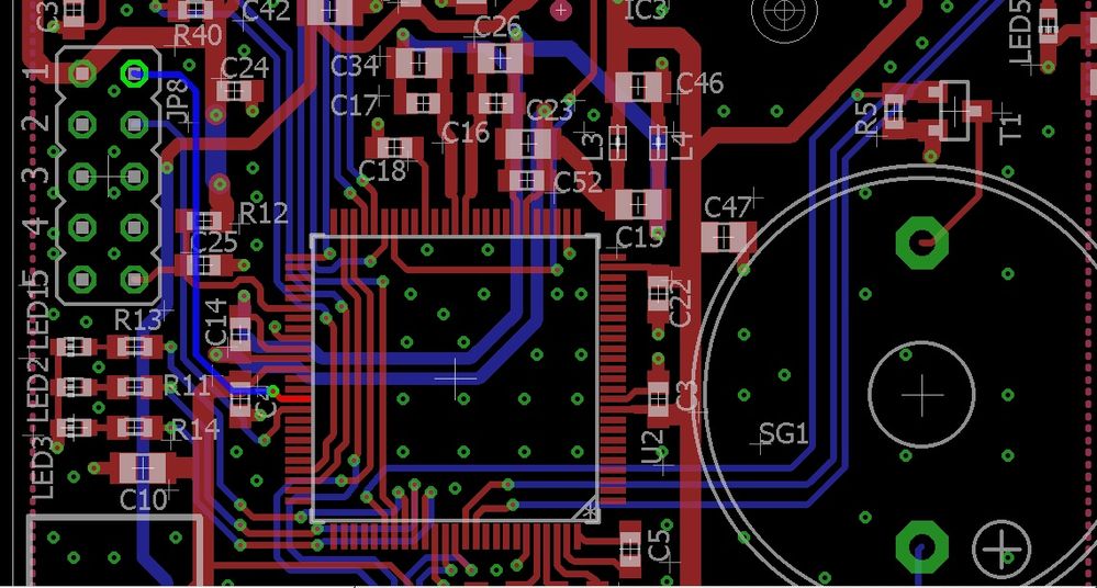

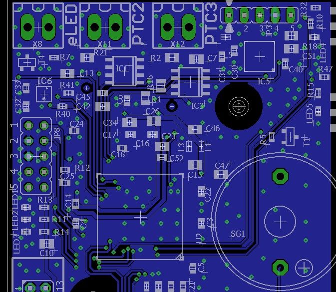

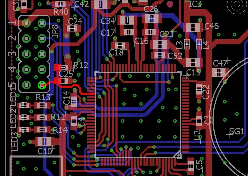

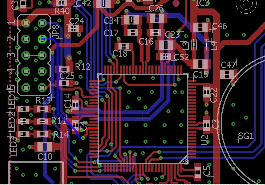

manfredeggersdo
yes I can do that:
JP8 is the SWD debug connector - standard 2,54mm.
All Pictures showes the same layout - I have highighted the different nets:
From top down:
* schematic µC and Debug Port part
* both layer VCC highlighted
* bottom layer GND highlighted
* top layer GND highlighted
* both layer SWD DIO highlighted
* both layer SWD CLK highlighted
I found out in the meanwhile, that the debug - using Kinetis Design Studio and the PEMicro-Interface (Using the debut port of TWR-KM34Z75M with short cable) works - but not the programming using this interface via mass storage - and I don't have any explanation for this behavior.
With best Regards
Manfred

Hui_Ma
Hi Manfred,
From your attached schematics, I would recommend R12 to use 4.7Kohm pull up resistor, the 470ohm pull-up resistor is too strong.
For you are using TWR-KM34Z75M board as a PEMicro debugger tool, please remove the 0 ohm resistors (R133, R134, R135 & R136) to cut the connection with TWR-KM34Z75M board's KM34 chip.

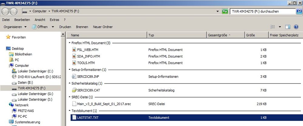

manfredeggersdo
R133, R134, R135 and R136 is disomounted.
I changed R12 to 4k7 - but it is still the same behavior.
And btw.: in Laststat.txt is following Error stored after I tried to program via mass storage mode:
Error. Validation of programming scenario failed.
Do you mean, that I can update the PE-Micro firmware of the Tower Module to Segger Jlink-Firmware?
How?
In my opinion it is a PE Micro.
Best Regards
Manfred

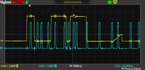

Here is a screenshot of the data waveforms - measured at JP8
Blue: swd_CLK
Yellow: SWD_DIO
stored while Kinetis design Studio runs in debug mode (and program runs)

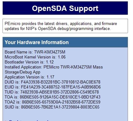

Hui_Ma
Yes, you could update the TWR-KM34Z75M on board OpenSDA firmware to Segger J-Link.
Please check below useful video/thread/document about how to update the OpenSDA firmware:
Updating the OpenSDA Firmware - YouTube
Update OpenSDA on my FRDMK64F?
OpenSDA Update Instructions for Freescale Freed... | element14 | Freedom development platform
Below are the Major steps:
1. Hold down the reset button on your TOWER board
2. While holding the button down, plug the USB cable into OpenSDA USB socket, and then release the reset button
The board will enumerate as BOOTLOADER
3. Drag and drop the Segger J-Link for OpenSDA v1 image file into the BOOTLOADER drive
4. After it finishes copying, unplug the TOWER board, and then replug it back in. This is the point where the bootloader firmware is updated.
Wish it helps.
Ma Hui
5,309 Views
manfredeggersdo
for the reason, that the Segger OpenSDA does not provides a mass storage device (MSD)  -  took the newer Image of segger for the TWR-KM34Z75M:
SEGGER - The Embedded Experts - Downloads
Now it looks very good!
Many, many thanks to you!
