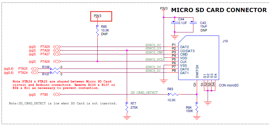

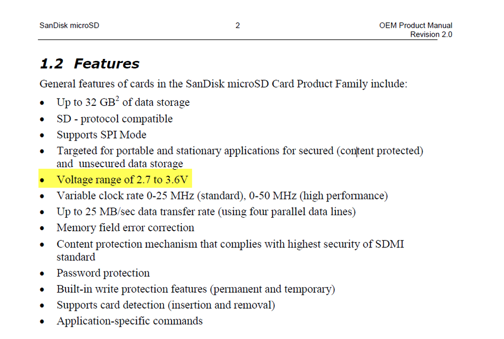

kerryzhou
Hi Alfredo,
   FRDM-KL28 already power the SD card with 3.3V, please check the schematic:
About the Sandisk, you can check the user manual which I find from the google:
https://www.google.com/url?sa=t&rct=j&q=&esrc=s&source=web&cd=2&cad=rja&uact=8&ved=2ahUKEwjyrOnt8c7i...
You can find
About the 1.8V SD card, you still need to find it by yourself, I search the web, find this information may useful to you:
Low Voltage Signaling - SD Association
So, maybe you can check micro SD, whether they have the LVS SD card or not.
Wish it helps you!
Kerry

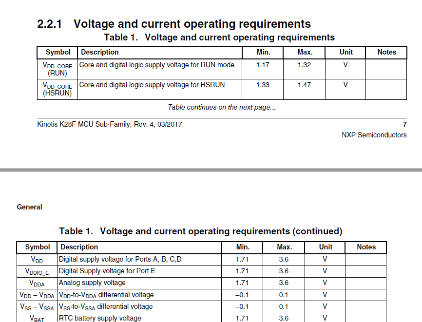

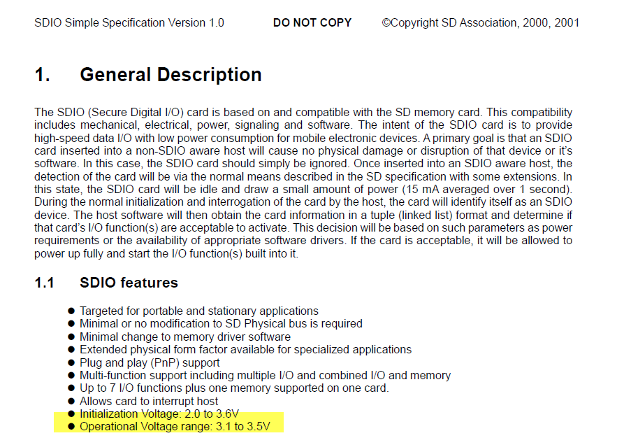

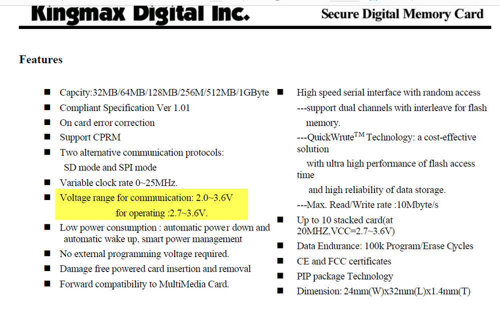

kerryzhou
Hi Alfredo Perez Grovas,
    In my opinion, the main problem is not in the NXP kinetis chip side, it should in the SD card side.
   Just take kingmax SD card as an example,
Even you check the SD specification, you can find this information:
The initialization volage is 2V to 3.6V, that's the root reason why you can't find it. This is the SD card feature, and as I know, this is the standard feature.
The K28 can work with 1.8V, but the SD card can't work.
So, if you want to use the SD card, you need to use the voltage at about 3V.
