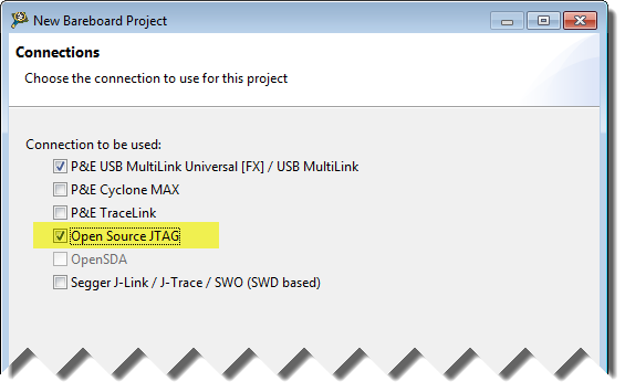

I'm trying to configure the debug configuration on  Eclipse to use the OSBDM. I didn't found AN about this possibility... Is there someone who did it ?

Oh, sorry :smileyconfused:, I think I read between lines that you were using CodeWarrior. In that case I think you would need a plugin. Maybe you can ask to P&E Micro if they have something like that.

Hello Jay:
When you create a new project, you have the option to select OSJTAG from the new project wizard:
If you created a project without support for OSJTAG, then you can add a new connection from the debug configurations. In the attached video, the project was created only with P&E Universal Multilink connection, and I cloned the settings to add OSJTAG support.
Hope this is useful!
