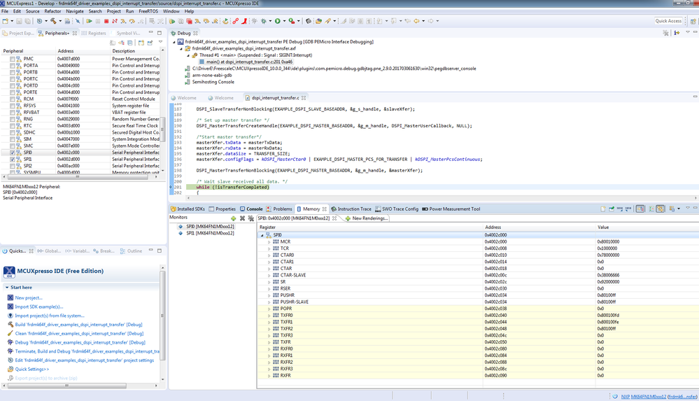

I am working with MCUXpresso and I have an issue with the SPI program "dspi_interrupt_transfer" provided by the FRDM-K66's SDK.
Actually when I debug it and try to look inside the SPI0 and SPI1 registers these ones remain disabled in Memory -> Monitors Window.

As I have not FRDM-K66 board, I use FRDM-K64F to have a test for the exmple dspi_interrupt_transfer with the MCUExpresso tools and SDK, the example use SPI0 as master spi, use spi1 slave spi.
I can see the spi register value as the following screenshot.
Hope it can help you

However it doesn't help me. It seems to be an IDE issue.
A new release of MCUXpresso has been brought and now allows to monitor only SPI0 (master).
But I still can't monitor SPI1 (slave) with my own program and the SDK example.

If you can watch the SPI0 register, can not watch the SPI1 register, i think it is debugger issue of the MCUExpresso, it is not related whether you connect the SPI signals between SPI0 and SPI1.
